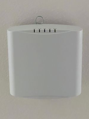

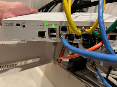

For detailed understanding of the issue please let us know the LED status of the switch and the access points using the below guide.
R510 LED lights
RUCKUS LED lights
Also please share the image of the switch and the access points showing the LED status and the cable connections.
12-12-2023 09:29 PM
See photos below.

Hi @JTAT
Thanks for your response,
Based on the images you have shared it seems like the switch has green lights on it which means that the lights are in normal state.
In order to verify whether the switch is able to transfer power to PoE devices we need to take console access to the switch.
To check this, first, we have to get access to the switch, and there are Two ways to get access to the switch.
ICX7150-C12 Router>
Show version
Show inline power
Show inline power detail
Once you are logged in to the ICX-7150-C12P please follow up the same steps that are on point '2'
