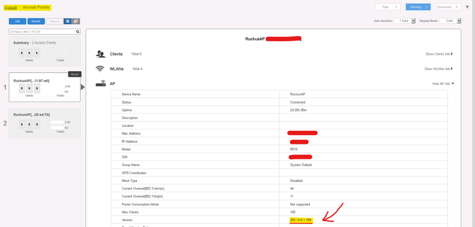

Could you please login to your Unleashed system on a web browser using Master AP IP Address or ‘unleashed.ruckuswireless.com’? Please check the current version of your Unleashed Access Points and share a screenshot of the same.
Please refer to the below screenshots for more information on how to know your Unleashed Access Points version details.
