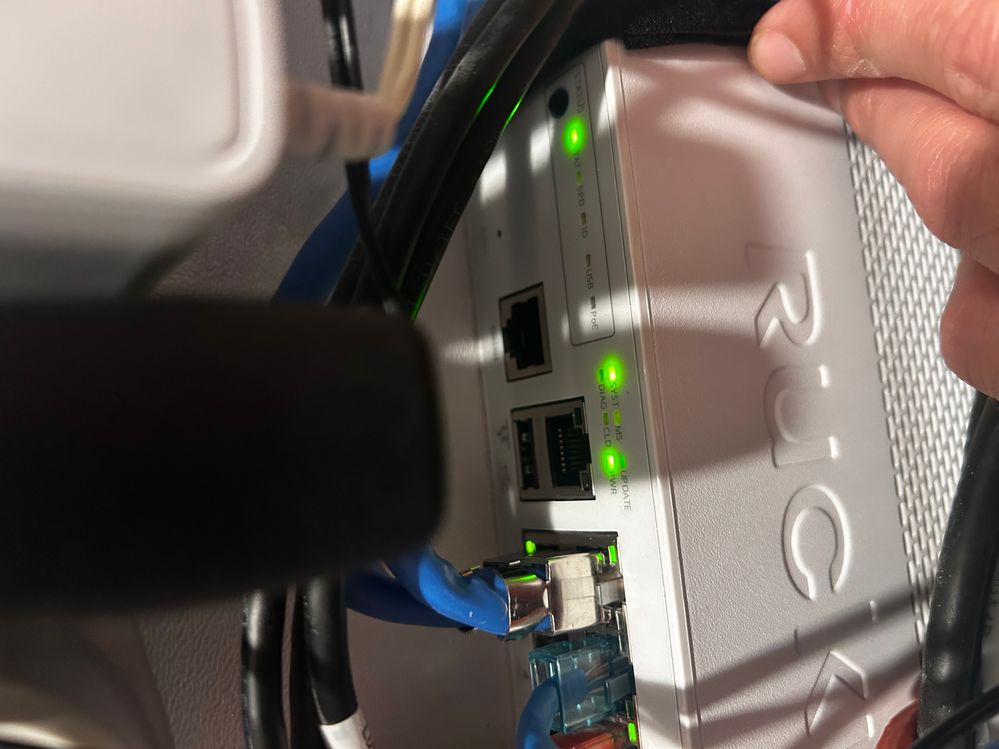

2. Picture attached - The switch is showing only green lights for the following areas: PWR, SYST, STAT. All other lights are not illuminated.

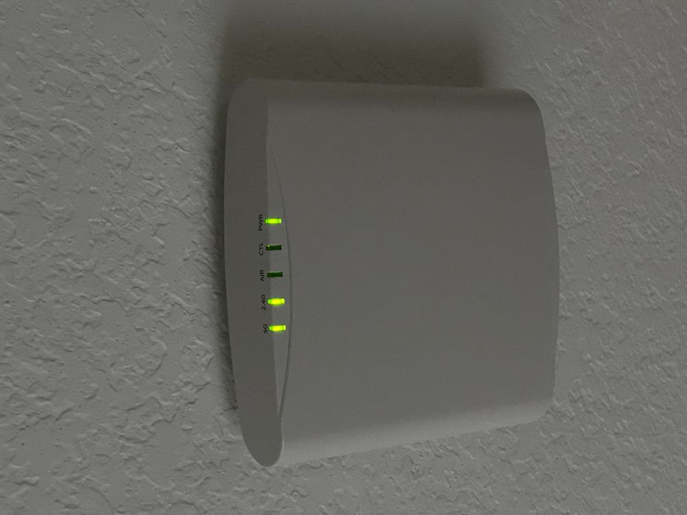

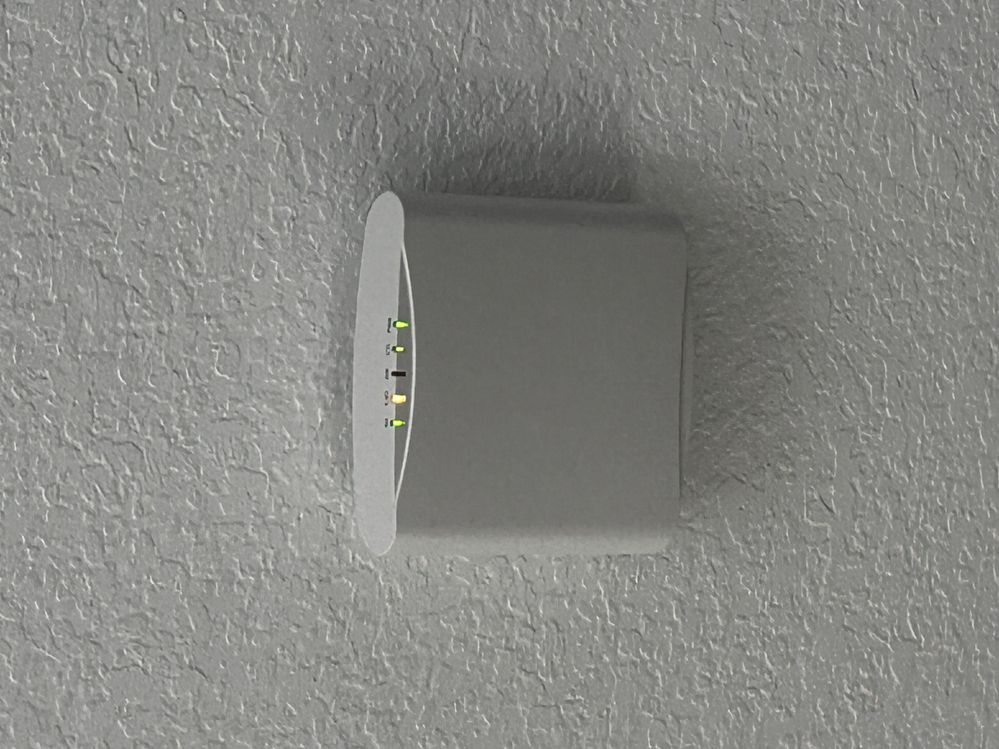

4. There are 2 AP's connected to the Ruckus switch. Photos Attached showing lights. AP1 shows PWR, 2.4G, 5G illuminatedAP 1
AP 2
Swtich green. AP2 shows PWR, CTL, 5G as green and the 2.4G as amber.
10-16-2025 12:05 PM
Hi @jakeherr1
Thank you for your response and for providing the detailed information.
The issue you're experiencing may be related to a routing code problem following a power outage.
To troubleshoot and resolve this, please refer to the following RUCKUS Lennar Knowledge Base article:
https://community.ruckuswireless.com/t5/RUCKUS-Lennar-Support-Knowledge/Fixing-RUCKUS-ICX-7150-C12P-...
Please let me know how it goes or if you encounter any issues during the process, I’ll be happy to assist further.
