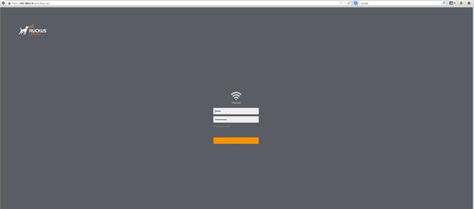

From the response shared, I  could understand that you are unable to login to the Unleashed App.
Could you please try accessing your Unleashed system using a laptop web browser? You can do this by entering the Master AP IP Address or by visiting https://unleashed.ruckuswireless.com/. Just make sure you're connected to the RUCKUS Wi-Fi network.
If you’re still unable to access it and don’t know the IP address of your access points, please refer to the guide below for help in locating the IP address:
How to find the IP address of RUCKUS devices using free applications:
Once you've found the IP address of the AP, you should be able to log in and see the Unleashed dashboard.

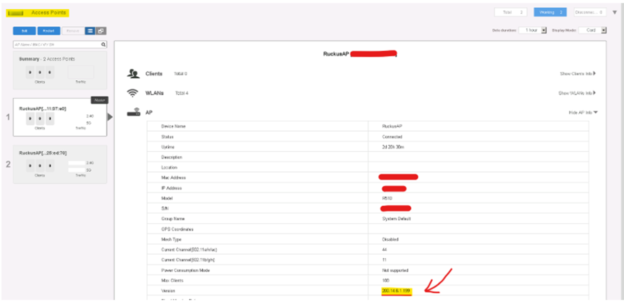

Please check the current version of your Unleashed Access Points and share a screenshot of the same.
Please refer to the below screenshot for more information on how to know your Unleashed Access Points version details.
Please help us with the above requested information and let us know if you have any queries in this regard.
