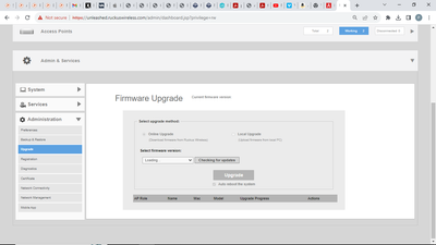

10-26-2023 05:05 PM
Thanks for the updated information on the upgrade process. I reviewed the videos and was trying to upgrade the two APs. Neither one showed in their status that they needed to be upgraded. I am currently in the unleashed browser app using the Upgrade tab. It is waiting on upgrade information to load... See image below:
How long should this process take? I have been waiting about 30 mins so far...
Thanks!
PDBars
10-27-2023 08:06 AM
Hi @PDBars
Please try to upgrade using the Local Upgrade option and let me know if any issues.
10-27-2023 08:51 AM
Tried and failed - the Unleash browser app will not let me select the local upgrade option...
The window does not let me select anything...

10-27-2023 09:25 AM
Hi @PDBars
Could you please try to reset your Access Points once again as I don’t see your Access Points listed on the upgrade page in the picture you shared. Please note, factory reset will wipe out the current Wi-Fi network and other configurations.
Please share your Access Points serial numbers so that I can check them internally with its designated team if they are registered.
