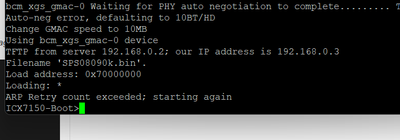

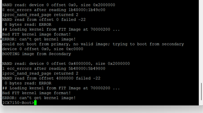

I had another power outage and tried the following steps about to restore the PoE but getting this issue when trying to load the images using this steps
This is the image of error i am getting on Putty console
Can you assist ?
