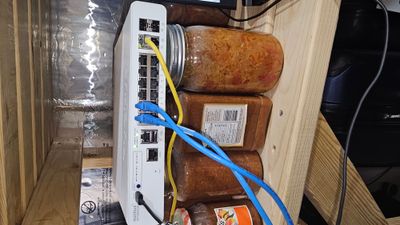

My rockus switch stoped working after power outage.
Dmitry
I tried to unplug it, tried to recet it, many times non of them worked.i have power and syst lights green. But ports where my smart home conected is  yellow.No power going to ap.

Hi @Dmitry
Thanks for your response.
If the resetting process doesn't work, we need to perform a software recovery.
Here is the quick guide to perform software recovery.
Note: after fixing the issue of the Switch been stuck in boot mode, please perform an upgrade to the code 08095g UFI and upgrade both partitions with the switching code file named SPS08095gufi.bin, so perform the software recovery using the code 08090k with the upgrade image file named SPS08090k.bin, then when the switch is back to normal upgrade to the file SPS08095gufi.bin for both partitions primary and secondary.
