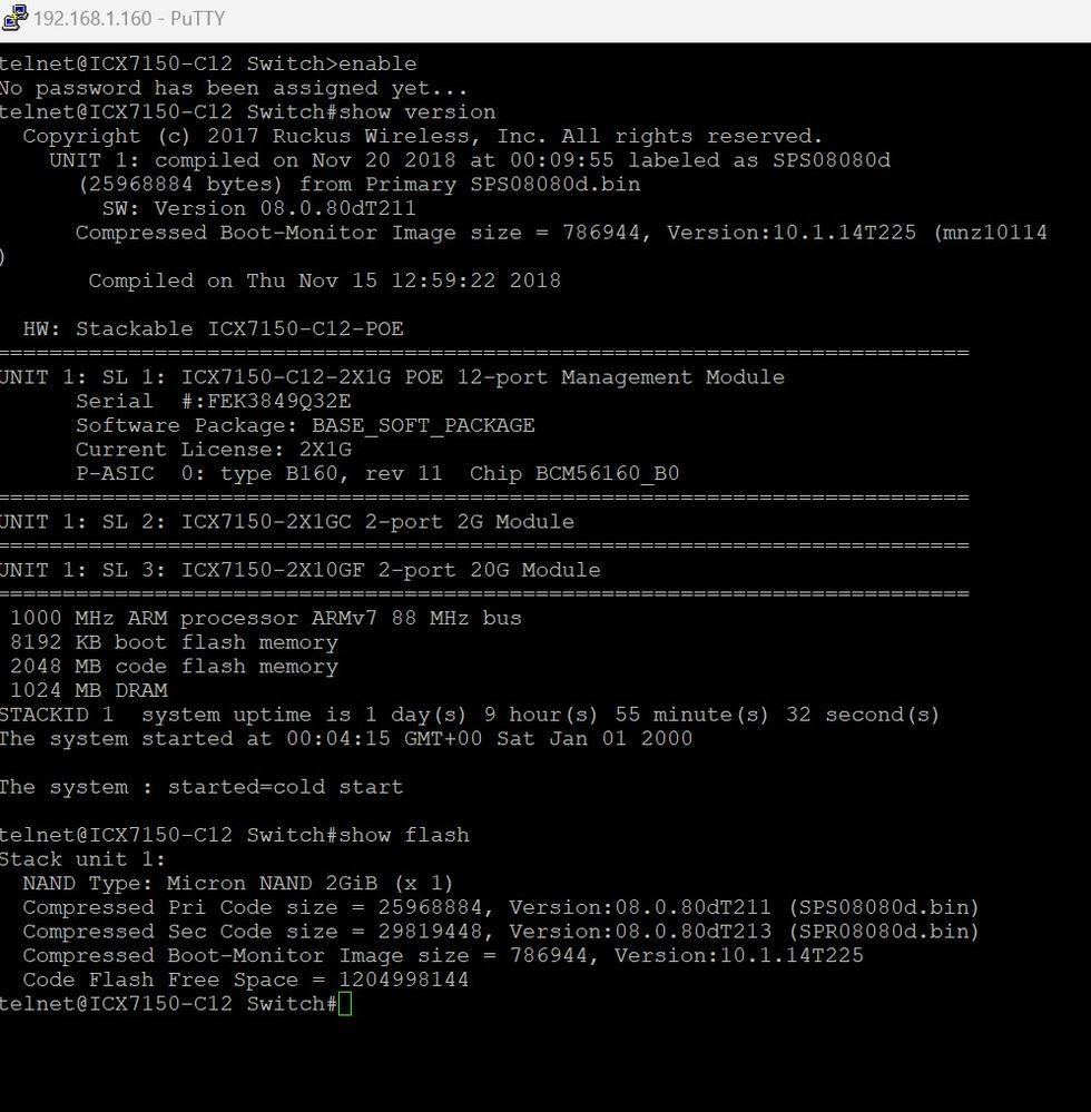

Hi @sramakrishna26
Could you please try the Telnet option to log in to CLI (Putty)? - Please refer below
Telnet – Port 23
If it is not working, could you please try to login into the Switch via a web browser using your Switch IP address?
Please let me know if you have any queries in this regard. Also please share the screenshots if you are unable to SSH or Telnet.

Telnet worked!

Hi @sramakrishna26
As I can see from the screenshot you shared, the secondary partition is running on the Routing code (SPR). The Switch should run on the Switching code (SPS) to avoid these issues for Lennar home users. Due to a power outage/power spike, the Switch boots up on the other partition which may be running on a ‘Routing Code’ results in causing this issue.
Please Enter the below commands in CLI to fix this issue:
copy flash flash secondary
reload
y
Lennar Home Community.
04-17-2023 03:51 PM
when I type copy flash flash secondary on the telnet screen, it says "Copy Failed"
04-17-2023 03:56 PM
I think it rebooted after last command, (boot system ..), but did not come back.
