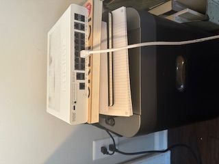

On your switch while it's plugged into the outlet, do you see any lights on? (Amber or green) Please let us know which lights are on. (Please refer to the below picture and share a picture of the same, showing the light status and the FULL Switch panel cable connections to the Switch ports)

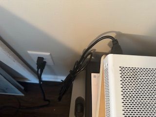

Pictures are attached to this thread. As mentioned before, the only lights I can see are the ones when the switch is plugged into the power. At that moment, all lights flashed out amber and then nothing. ruckus001.jpgruckus002.jpg

Could you please plug your ICX-7150-C12P Switch into a working power outlet and send us PICTURES and VIDEO of it showing the light status, and cord connected to the Switch and a working power outlet? Please refer to the below pictures as an example.
