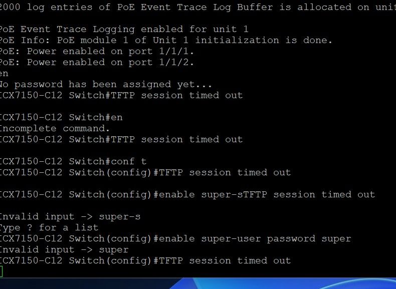

Hi, I was able to download the drivers for the USB to UART Bridge Controller and connect through the PuTTY Terminal.  I followed the video step-by-step to reboot the switch and enter Bootloader mode.  After the PoE starts to enable the ports, then the following keeps repeating:  "TFTP Session timed out".  If I type in "conf t", I get to (config) mode and enter "enable super-user password super" it tells me Invalid Input-> super; I tried "password" also and get the same error.  See screen shot:Invalid password.jpg

Here is the correct way to create a username 'super' and password 'pass' as example
ICX7150-48ZP Router(config)#username super password pass
Here is a short guide from a external website
https://luiscachog.io/configure-ruckus-switch/
You do not have to be worry about the  ' TFTP session time out ' that's normal  is trying to get a configuration file from the TFTP server but there is no response from the TFTP server.
