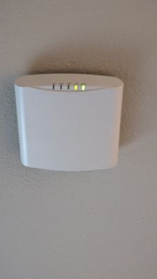

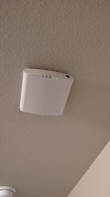

I just bought a Lennar home that has a Ruckus mesh system installed. I am having issues getting the mesh system to work. More specifically the green PWR LED will not stop flashing. This seemed to occur when I had installed my router which is a Netgear Nighthawk.

1. For detailed understanding of the issue please share the image of the switch and the access points using the below guide.
R510 LED lights
RUCKUS LED lights
2. Please confirm the cable connection of your device from your router to the switch.
3. Also please let us know how many access points are connected to the switch.
โ11-21-2023 06:31 AM
Good morning,
Thank you for the pictures and the guides. I can confirm that the mesh access points are connected to the switch. I have two access points connected to the switch. One thing I forgot to mentioned is that therer was a potential power outage a couple weeks back. I do remember that prior to this potential outage that the access points were working. However, I cannot confirm that the power outage was the source of this issue as I was not home at the time.
โ11-21-2023 07:54 AM
Hi @Eldude65
Thanks for the information.
As I have mentioned in the previous post, please share the image of the switch and the access points showing LED status and the cable connections as mentioned below.
โ11-21-2023 07:56 AM
โโHere are all three. The lights are still blinking.
