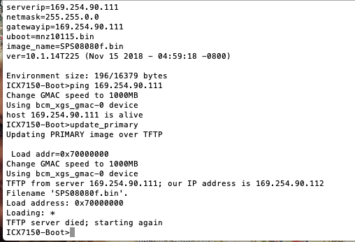

Have been without my Ruckus System now for about a year and finally taking the time to get it up and running again.
To begin I am on a MAC Book pro utalizing a usbc-usb and Ethernet -Ethernet port to communicate with ICX7150.
I have downloaded all the latest software and am trying to upload it to un-brick my ICX.
I can successful set all my IP setting in accordance to my Ethernet connection as described and can successfully ping my connection, but when I go to update_primary TFTP fails.
All firewalls are down when attempting this!!!!!!

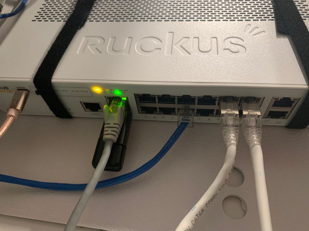

And just because every post I have seen asks for the picture of the extender here it is. No lights at all
07-31-2023 07:12 AM
Hi @Mmezz
Greetings of the day,
Based on your description your switch has one green and one yellow light, it means that the switch is stuck in boot mode.

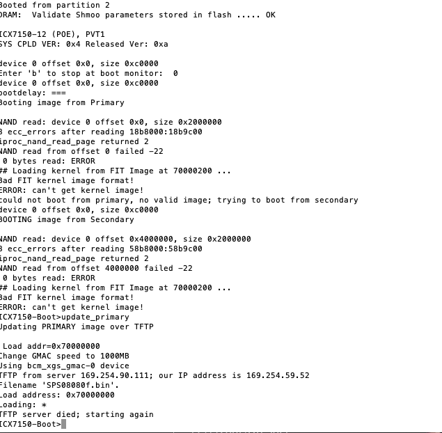

Have already tried this and following the steps to take out of boot mode with the latest software revisions please see the terminal above in the pictures. Ruckus is unsuccessful in loading based on the procedure for “getting out of boot mode.
i have tried resetting with a pin and the reset button multiple times. The system flashes all amber and will not stop
07-31-2023 09:27 AM
PLEASE NOT TERMINAL ABOVE. Ruckus ICX will not accept software recovery via usb or TFTP
