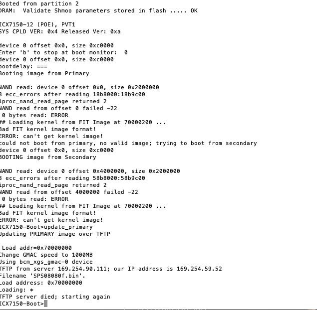

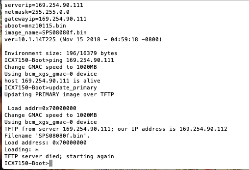

I have downloaded all the latest software and am trying to upload it to un-brick my ICX.
I can successful set all my IP setting in accordance to my Ethernet connection as described and can successfully ping my connection, but when I go to update_primary TFTP fails.
All firewalls are down when attempting this!!!!!!

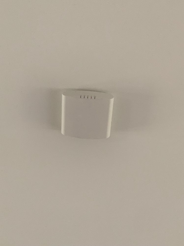

And just because every post I have seen asks for the picture of the extender here it is. No lights at allPOE.jpg

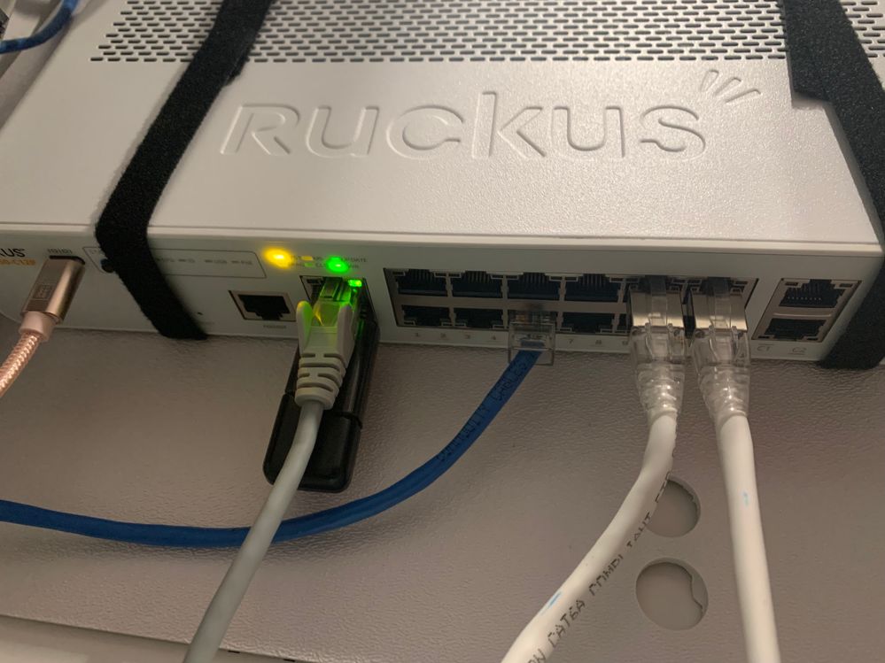

Based on your description your switch has one green and one yellow light, it means that the switch is stuck in boot mode.
  1.  Remove power from the switch.
Have already tried this and following the steps to take out of boot mode with the latest software revisions please see the terminal above in the pictures. Ruckus is unsuccessful in loading based on the procedure for “getting out of boot mode.
i have tried resetting with a pin and the reset button multiple times. The system flashes all amber and will not stop
Mmezz
PLEASE NOT TERMINAL ABOVE. Ruckus ICX will not accept software recovery via usb or TFTP
