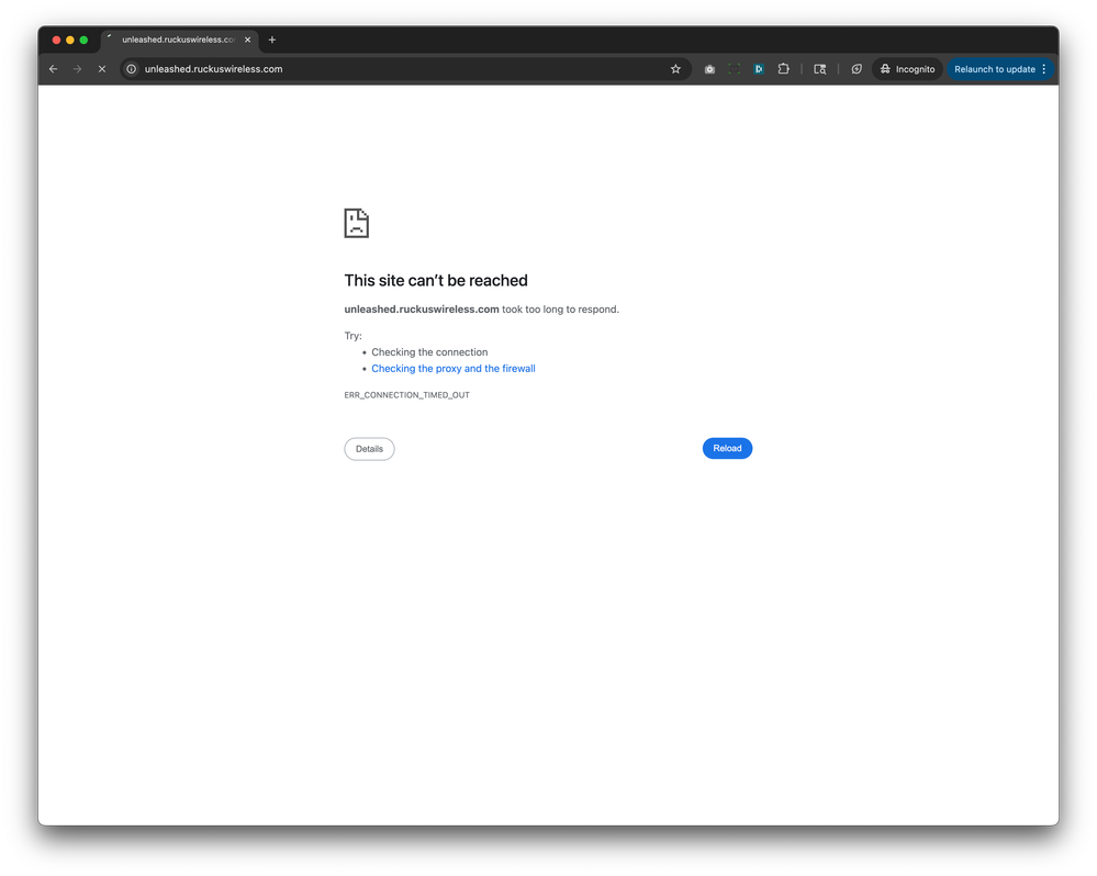

I've included the IP address ICleanShot 2025-09-09 at 09.44.34@2x.png got from the scanner, and I'm also seeing configure.me wifi, which I believe is related to the system, but nothing happens when I connect to that as well.
Hello @inkmark
Pinky Rajendran,
Yes, I still need assistance. I am not able to connect to my network to manage it from the app or website. I did not receive a response to the requested screenshots or the following steps to get this remedied.
Thanks
-Mark
Hello @inkmark ,
Could you please share the screenshot of the IP address scanner showing the IP address of all Ruckus devices?
Sure I can reupload it.  I'm only seeing these two Ruckus. I also have started seeing this wifi as well.CleanShot 2025-09-09 at 09.32.47@2x.pngCleanShot 2025-09-09 at 09.38.16@2x.png
