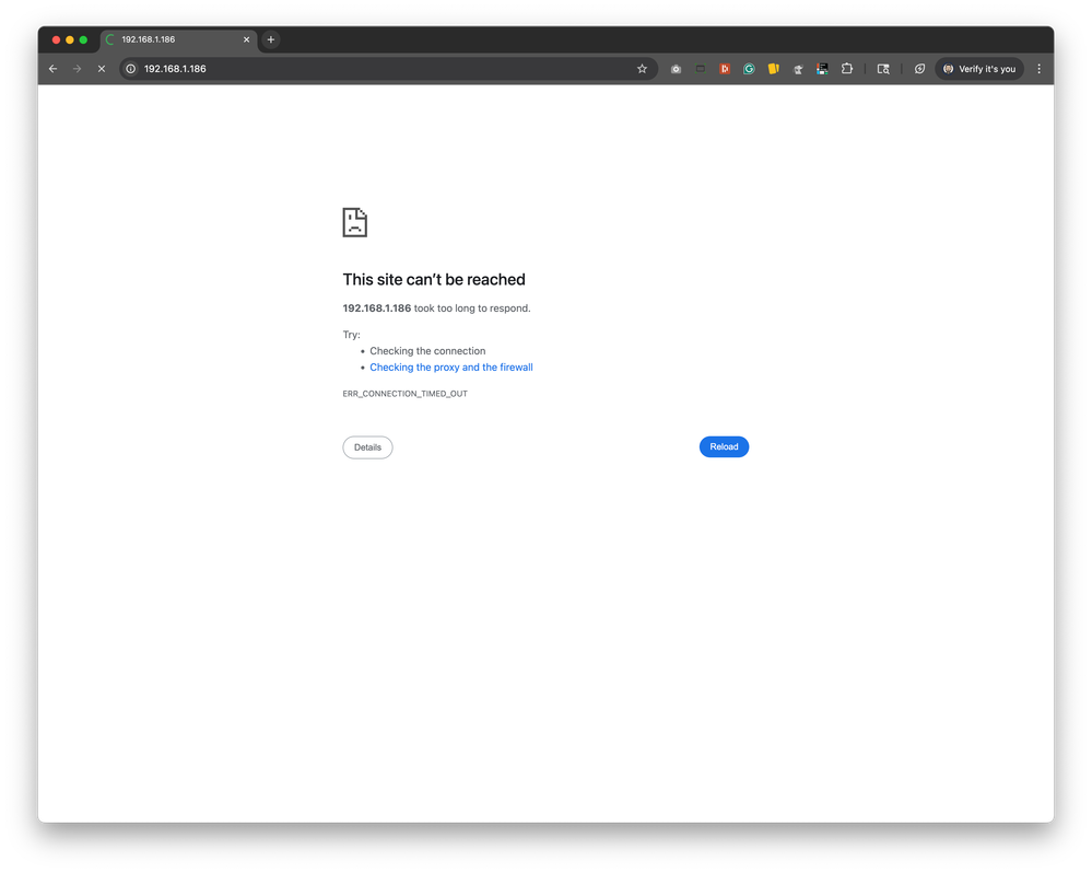

09-12-2025 09:21 AM
Connected to the Ruckus wifi. This si the error message I get.

09-12-2025 08:35 AM
Hello @inkmark ,
Please login to your Unleashed system using the second IP address, which is the IP address of the RUCKUS Access point .
Please make sure you are connected to the RUCKUS Wi-Fi Network to access the same.
You should see the below-Unleashed dashboard after finding the IP Address of the AP. Try to log in
Please check the current version of your Unleashed Access Points and share a screenshot of the same.
Please refer to the below screenshot for more information on how to know your Unleashed Access Points version details.
