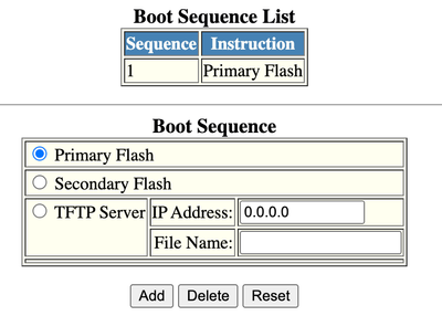

A week ago we had a brief interruption in power (5-10 seconds). Since then, our wireless internet is barely working and most of the time is not working at all. I have looked through the forum and switched the boot sequence but that did not work. I hard reset the aps and switch, deleted and reinstalled the wifi networks through the unleashed app and still have not found a solution. In the unleashed app it shows the APs as connected and broadcasting wifi but the switch is 'disconnected'.

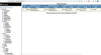

As discussed earlier, this issue is because your switch is running on the Routing code (SPR). The Switch should run on the Switching code (SPS) to avoid these issues for Lennar home users. Due to a power outage/power spike, the Switch boots up on the other partition which may be running on a ‘Routing Code’ results in causing this issue.
As I can see from the output you shared, your Switch is booted up on the secondary partition which is running on Routing code (SPR) as highlighted in the below screenshot.

Thanks for trying to help. However, this method is not working. I have found the ip address and can even log into the switch by typing the ip address into my google chrome web browsing bar. However, I cannot access it through the "terminal" on my macbook. I get the error message:
*******:~ ******$ ssh [email protected]
Unable to negotiate with 192.168.1.72 port 22: no matching key exchange method found. Their offer: diffie-hellman-group14-sha1,diffie-hellman-group1-sha1
05-15-2023 03:56 PM - edited 05-15-2023 04:03 PM
added screenshots to the original reply.
05-15-2023 05:01 PM
Hi @bbradley01
Thank you for the response and update.
Your both primary and secondary Switch partitions are running on SPS code, which is correct.

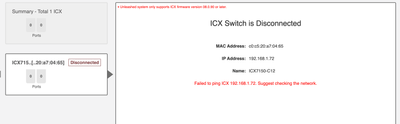

As your Switch is showing as pending/connecting it could be for multiple reasons, (Please refer to the below picture)
Please follow the below steps to get Switch in sync with Unleashed. We will delete the Switch from Unleased and Add it back.
Steps to synchronize the Switch (ICX-7150-C12P) to the unleashed Access Points:
Switch side:
Make sure the management approval is enabled.
Access Points (unleashed):
On the Unleashed dashboard
1. Remove the existing Switch from the Unleashed (Please refer to the below picture):
2. Hit Add on that dashboard
3. Put the IP address of the ICX switch (ICX-7150-C12P) and Password (Same username and password you used for accessing the Switch from a Web browser).
4. Username and password for Switch authentication are the same as what you use to log in for Switch on a Web browser or CLI (Putty).
To sync the data, it will take us a while, so after a couple of minutes, it should say connected.
Once the Switch gets synchronized, please check the dashboard again.
