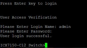

First problem is that I can't locate the switch on the ruckus unleash dashboard (I got no idea why it isn't automatically connected and I got no knowlegde of the switch until lately). I am unable to get the IP address of my switch using the free IP search as none of the devices come up matches with the MAC address on the switch. So I connected to the switch via usb-c cable and follow the procedures for direct connection. First I check the verison of the flash:
ICX7150-C12 Router>show version
  Copyright (c) 2017 Ruckus Wireless, Inc. All rights reserved.
    UNIT 1: compiled on Nov 20 2018 at 00:20:22 labeled as SPR08080d
      (29819448 bytes) from Secondary SPR08080d.bin
        SW: Version 08.0.80dT213
      Compressed Boot-Monitor Image size = 786944, Version:10.1.14T225 (mnz10114)
       Compiled on Thu Nov 15 12:59:22 2018
  HW: Stackable ICX7150-C12-POE
and it looks like the switch is running as a router. Finally found the issue, yay.
I follow the procedure to enter the commands on Putty (enable, copy flash flash secondary, boot system flash secondary yes). However as it was running it the session timed out due to tftp?

Please access the switch via console (cable access) and please follow the next steps to fix this problem:
Write the following commands and hit enter to accept each command:
ICX7150-C12 Router#enable
ICX7150-C12 Router#copy flash flash secondary
ICX7150-C12 Router#boot system secondary yes

Hi @Alex1876
Please Try the following credential combination:
Username:                      Passwords:
  admin                             sp-admin
  super                              Lennar
                                          lennar
                                          ruckus
                                          Ruckus!
                                          Ruckus1
                                          admin
                                          password
If one of them works, the switch will prompt you to replace the default password with one of your choosing. Please go ahead and modify it, then save it for future use.
Kind regards,
Sofia Gätjens

Alex1876
So even though nothing is visible for password, the console still registers what you type. The password is Lennar. It doesn't give me the option to change the default username and pass. But nonetheless eveything is solved. Thank you very much!
