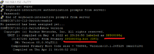

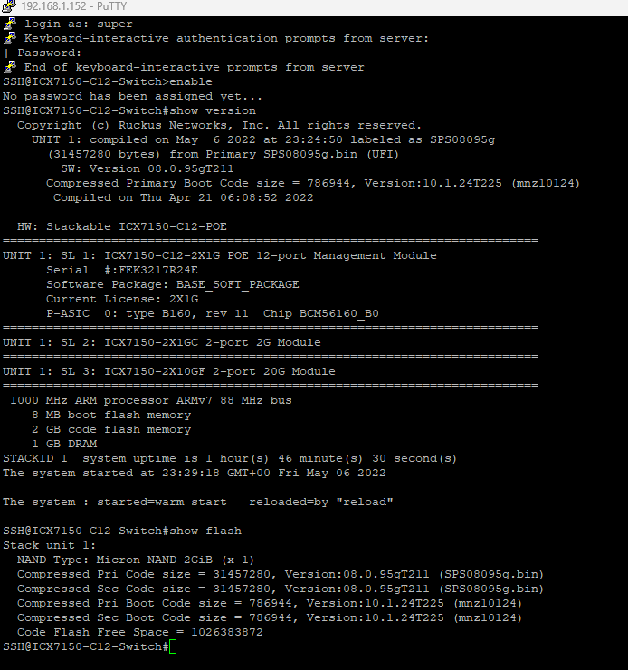

Hi @barnabei
Once again, please try to log into the command line, check, and share the mentioned command outputs.
show version
show flash
Please share the command outputs or screenshots if you encounter any issues or errors during these steps.
06-30-2025 12:42 PM
See attached
06-30-2025 12:51 PM
Hi @barnabei
Thank you for your response and for sharing the information.
Your Switch has now been successfully upgraded to version 08.0.95g (as shown in the screenshots below).
Please let me know if you have any questions or need further assistance.
