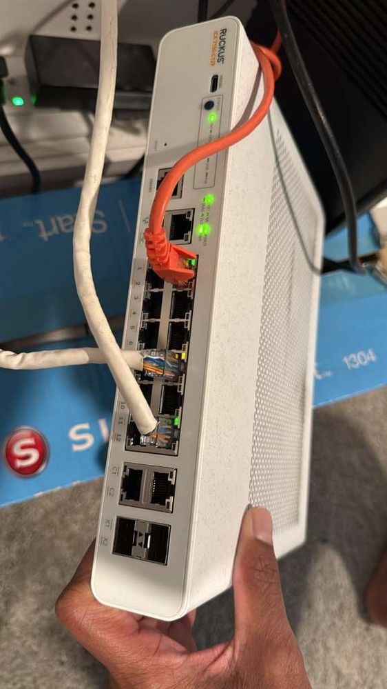

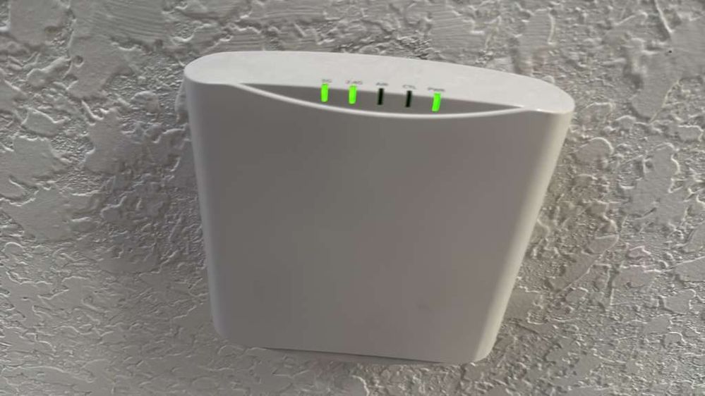

Hello @roshanbhandary
As per the case description, I understand that your RUCKUS setup is not working and having slow speed and intermittent issues.
1.  Was there any power outage before you started facing the issue?
2.  Please refer to the below picture and share a picture of the same, showing the light status and the FULL Switch panel cable connections to the Switch ports)
3.  May I know how many Access Points are connected to the Switch? Could you please let me know the light status on the Access Points? Any of these lights are on (Please refer to the below picture and share a picture of the same)
  1. Was there any power outage before you started facing the issue? - NO
  2. Please refer to the below picture and share a picture of the same, showing the light status and the FULL Switch panel cable connections to the Switch ports) - AttachedAccess Point - 1Access Point - 1Access Point - 2Access Point - 2SwitchSwitch
