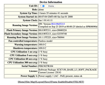

I received this information from the web portal. I have been unable to ssh into the switch through CLI. I have tried again today still with no success. If there is a way to change boot image from web portal that would be best for me.  thank you.
Hi @Rayoub
Before proceeding with the web option, could you please share the screenshots showing the below information?
Please share the ALL above queries and let me know if you have any queries in this regard.
Rayoub
Hi @Rayoub
Thank you for the response and for sharing the requested information.
Please follow the process as described in the below link on the web GUI:
WEB access option:
https://community.ruckuswireless.com/t5/RUCKUS-Support-for-Lennar-Homes/How-to-Fix-Routing-code-issu...
