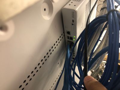

Based on the information provided, it appears that your RUCKUS Access Points are not powering on.
When your switch is connected to the outlet, do you observe any illuminated lights (amber or green)? Kindly describe which lights are visible. Additionally, please provide a photo showing the status of the lights and the full switch panel with cable connections to the switch ports.
 i only see two green lights, one for “pwr” and the other for “syst.”
Hi @Justin_rey95
Thank you for your response and the information you provided.
Based on the light status and cable connections to the RUCKUS ICX-7150-C12P Switch, everything appears to be in a normal state.
However, it seems that the RUCKUS Access Points or any devices connected to the Switch may not be functioning properly due to the Switch ports being disabled.
To assist you further, please refer to the following RUCKUS Lennar Knowledge Base self-help article for troubleshooting steps to resolve this issue:
No Power on Access Points and ICX-7150-C12P Switch with GREEN Light Status
If you encounter any difficulties during the troubleshooting process, please do not hesitate to reach out for further assistance.
