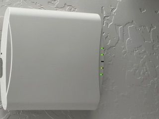

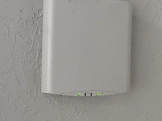

5. How many access points are currently connected to the switch? Please describe the status of the lights on the access points. Similarly, include a photo showing the access points' light status.

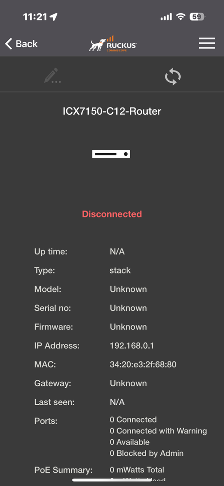

1)Yes it was operational before.There was a power outage and after that master was working and we changed Century link router and we lost even master connection and now we lost both AP. image0.jpegimage2.jpegimage1.jpeg
2)Now it says disconnected.

Regarding the status of the RUCKUS ICX-7150-C12P Switch, the light indicators are currently showing a normal state.
However, I see from the screenshot you shared, that your Switch has a Routing code (SPR) issue (Refer to the below screenshot). Please refer to the below RUCKUS Lennar Knowledge Base self-help article to troubleshoot and fix the issue.
https://community.ruckuswireless.com/t5/RUCKUS-Lennar-Support-Knowledge/Fixing-RUCKUS-ICX-7150-C12P-...
Additionally, I would like to bring to your attention that the Ethernet cables (yellow and red) connected to the Internet Service Provider's (ISP) router and other devices appear to be plugged into the wrong ports. It should be connected to one of the 1-12 Switch ports. Kindly disconnect the cables from their current ports and reconnect them to any available ports within this range (refer to the screenshots below for further clarification).
