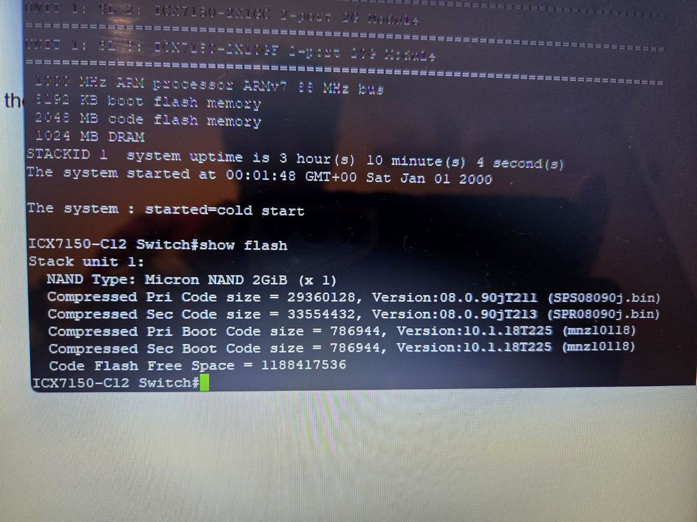

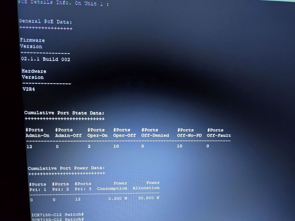

02-05-2026 08:41 AM
Hi Imran,
Ran the commands as you suggested and attached the responses from the CLI. Please take a look and let me know if I miss any.

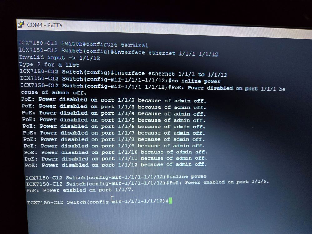

02-05-2026 09:51 AM
Hi Imran,
I tried the commands and received this message "ICX7150-C12 Switch(config-mif-1/1/1-1/1/12)#PoE: Power disabled on port 1/1/1 because of admin off.". Also did few other checks. Attached the output. Please verify.

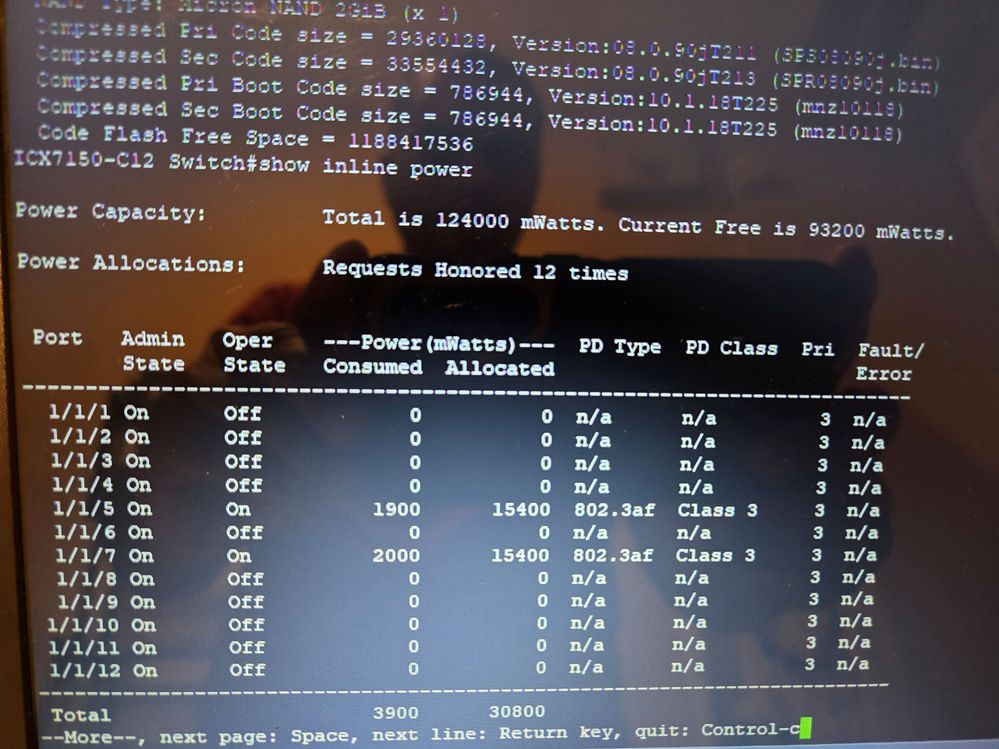

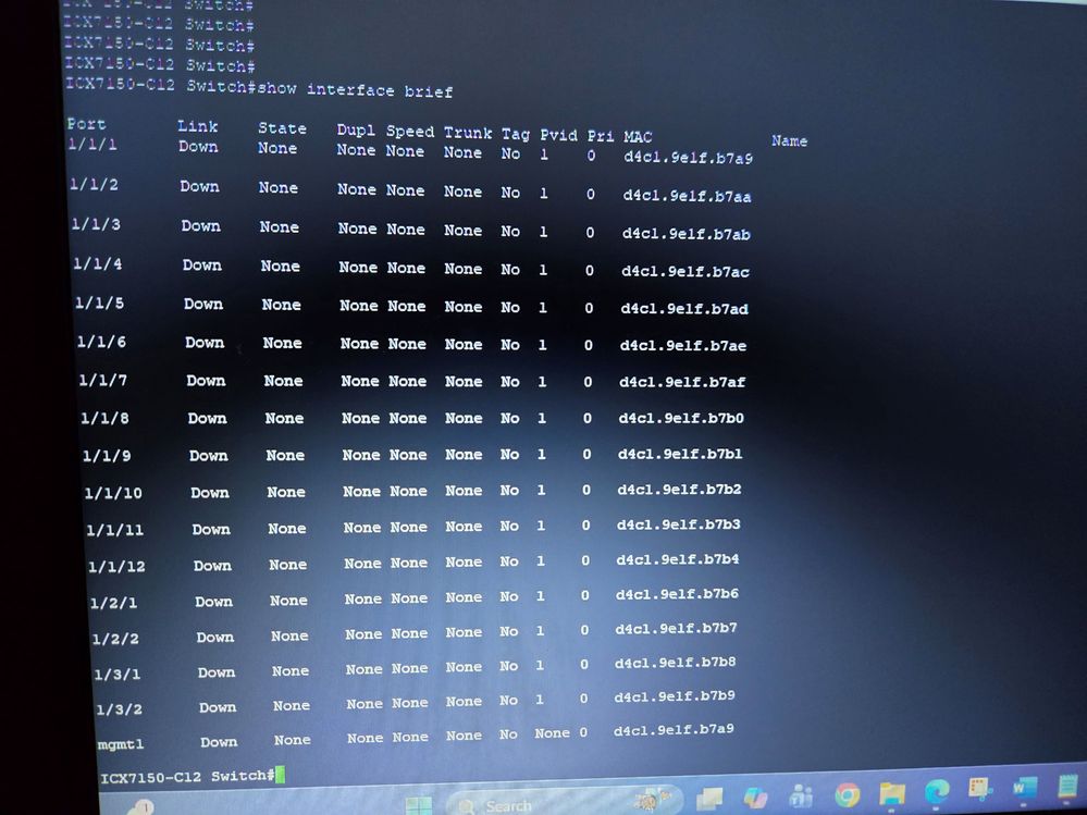

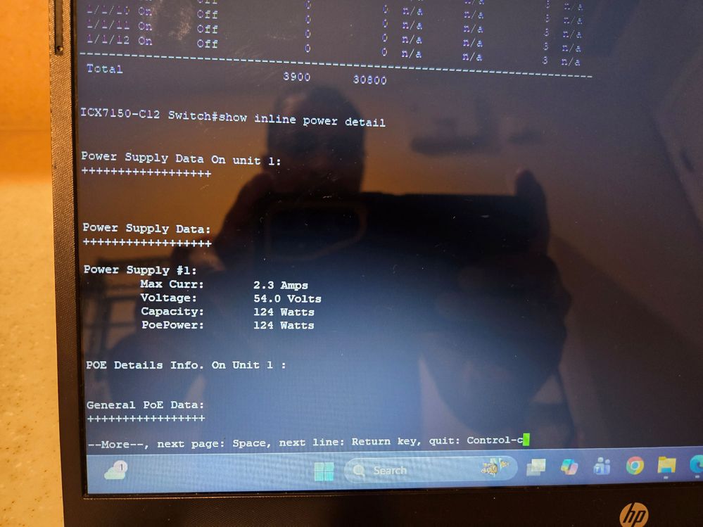

02-05-2026 10:11 AM
Hi @RaviShankar
Could you please share the outputs of the below commands? Additionally, please confirm the current status of the Access Points and Internet via them.

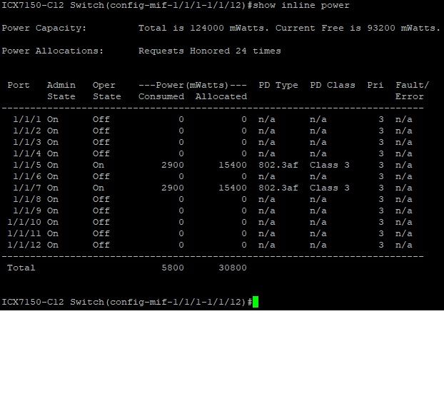

02-05-2026 10:39 AM
Hi Imran,
Internet and Access Points are still not working. Attached the outputs. Please check.
