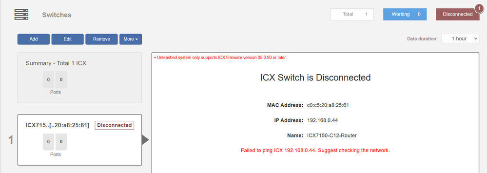

Hello, I own a Lennar home and it seems there are issues with the ICX7150 switch, it is showing as "disconnected" in the dashboard, see photo enclosed. Some devices in our network have issues, very slow speed and some apps don't work. There was a power outage last night if that matters.
I did a power reboot and the problem persists, all status LEDs are green color.
I downloaded the IP scanner software and did a search but I don't see an IP address for any ICX7150 switch, as suggested on other posts. Looking at my gateway's setting, the IP assigned to the ICX 7150 switch is 192.168.0.44.
I also did reset the ICX7150 switch but have no luck, by pressing the reset button using a paper click:
Is there anything else I can do?

Hi @rcanas
We appreciate the information you have provided regarding the issues with your RUCKUS setup following a recent power outage.
Based on the details you've shared, it appears that your RUCKUS ICX-7150-C12P Switch has booted up on Routing Code (SPR) highlighted in the screenshot below, as a result of the power disruption, causing the reported problems.
To assist you further, please refer to our RUCKUS Lennar Knowledge Base self-help article linked below. This resource provides detailed steps to troubleshoot and resolve the Routing Code (SPR) issue:
Please follow the instructions outlined in the article. Should you encounter any difficulties or require additional assistance, please do not hesitate to reach out to us.
Thank you for your patience and understanding as we work to resolve this matter promptly.

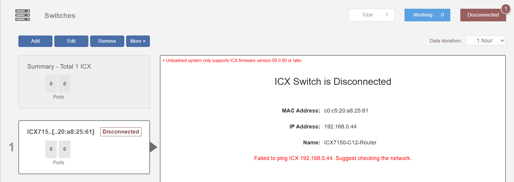

06-26-2024 06:30 AM - edited 06-26-2024 06:32 AM
Hi @rcanas
