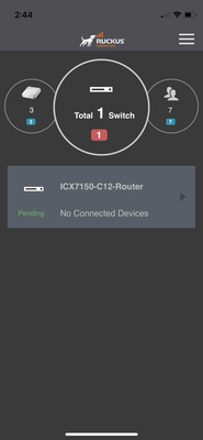

Is this correct? Or is my switch acting as a router? My internet connectivity is terrible! Hasn’t worked properly since power outage. Please help not tech savvy at all!!

Based on your description, the switch acting as a router is software issue and also if there was a blackout or power outage and the switch reboot because of that, most possible your switch starts running the wrong code which we call ‘routing code’ this is a known issue.

1- To fix this issue, we must identify the ‘currently’ IP address assigned by your local router to the switch
-We can try the IP address that shows in the dashboard copy and paste it in the URL if that redirects you to the login page for the ICX-7150-C12P that is the correct one if not.
