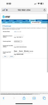

Can confirm the factory reset was completed while pass through was disabled (it has always been disabled)

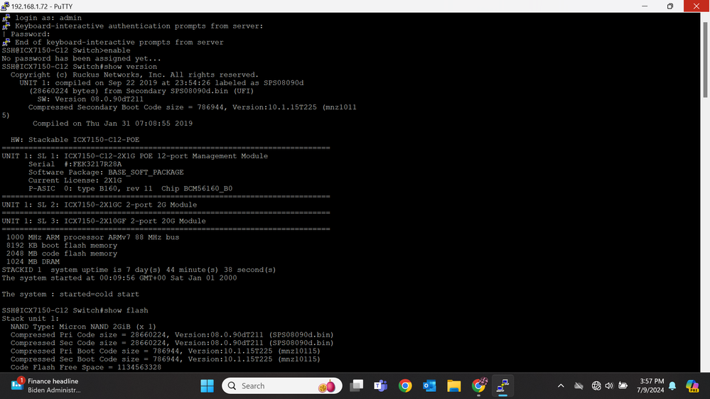

Once you login to CLI, please enter the below commands and share the output.
show version

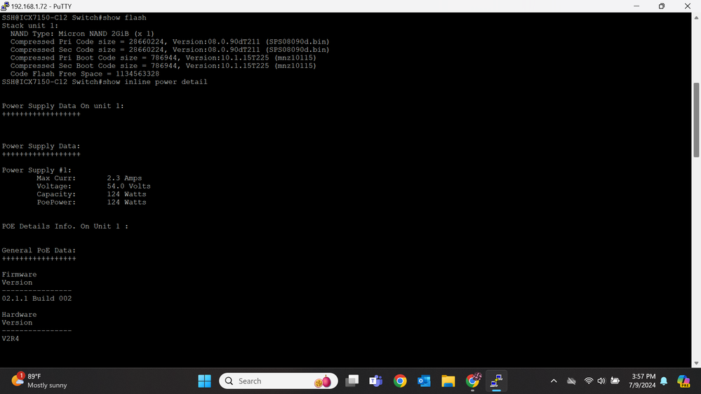

show flash
show inline power
show inline power detail

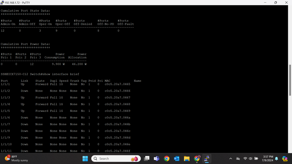

show interface brief

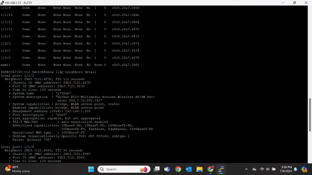

show lldp neighbors detail

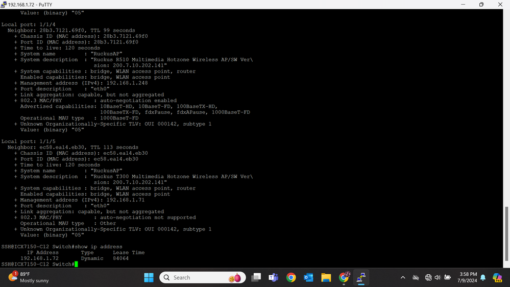

show ip address

Hello @bbradley01 ,
We recommend upgrading your Switch to stable version as it is currently running on old 08090d version. Regarding the Switch upgrade process, we recommend transitioning to version 08.0.95g, identified as the stable version for Lennar Home users.
To facilitate this transition, we have recently introduced an upgrade tool tailored to ensure a seamless process. Utilizing this tool is straightforward: users simply need to input the IP Address, Username, and password associated with the Switch into the software interface.
For your convenience, please find the necessary resources below:
We highly value your input and would greatly appreciate your feedback on our upgrade tool. Your insights are instrumental in our ongoing efforts to enhance user experience and ensure the tool meets your needs effectively. Please take a moment to share your thoughts, suggestions, or any issues you encountered while using the tool. Your feedback is invaluable to us and will guide us in further improving the tool for all our users. Thank you for your time and contribution.
Please observe the stability of the connection after the upgrade and keep us updated.
Should you require any assistance throughout the process, please do not hesitate to reach out. Your satisfaction is our priority, and we are here to support you every step of the way.
