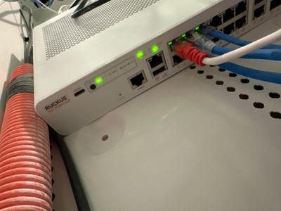

Could you please help us with pictures of your ICX-7150-C12P Switch showing the cable connections to the Switch ports

all lights are green.

Hello @bbradley01 ,
Thank you for the response and sharing the pictures.
Upon checking the pictures, we understand that the light status of the switch and the connection between the ports on the switch seems to be normal.
