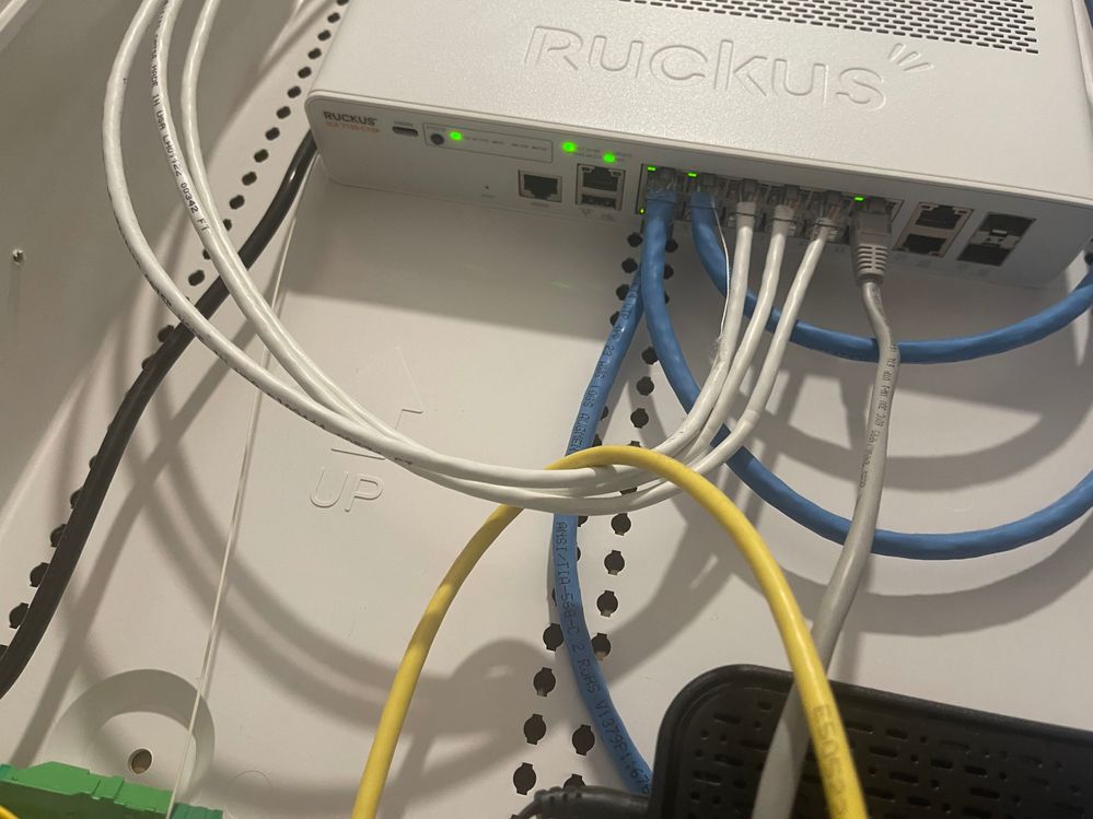

On your switch while it's plugged into the outlet, do you see any lights on? (Amber or green) Please let us know which lights are on. (Please refer to the below picture and share a picture of the same, showing the light status and the FULL Switch panel cable connections to the Switch ports)

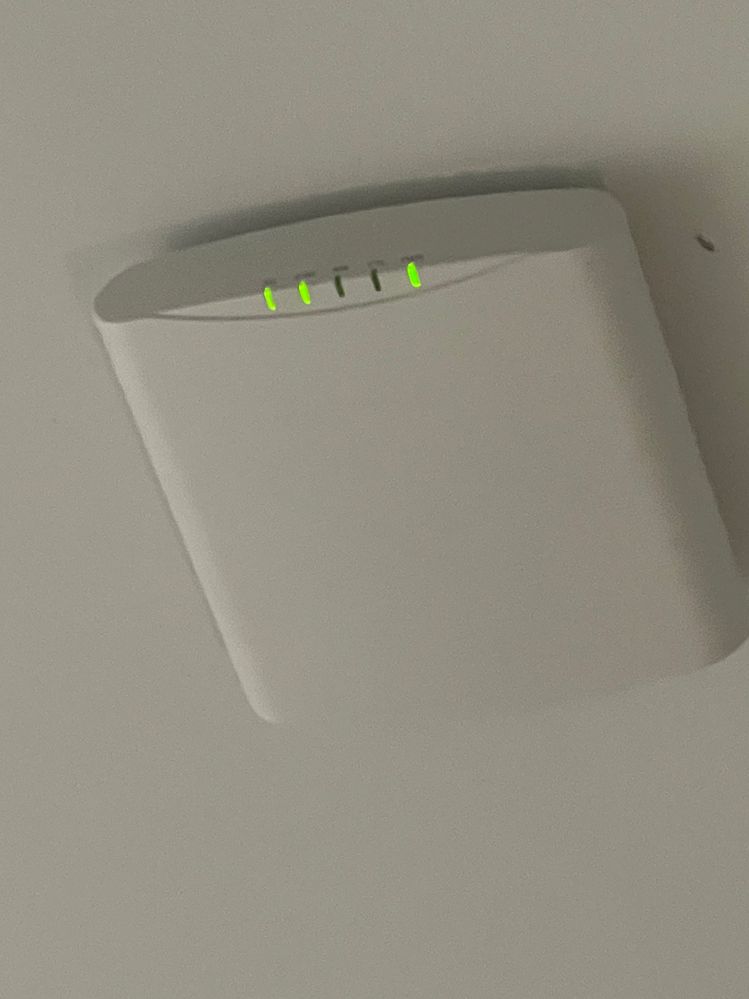

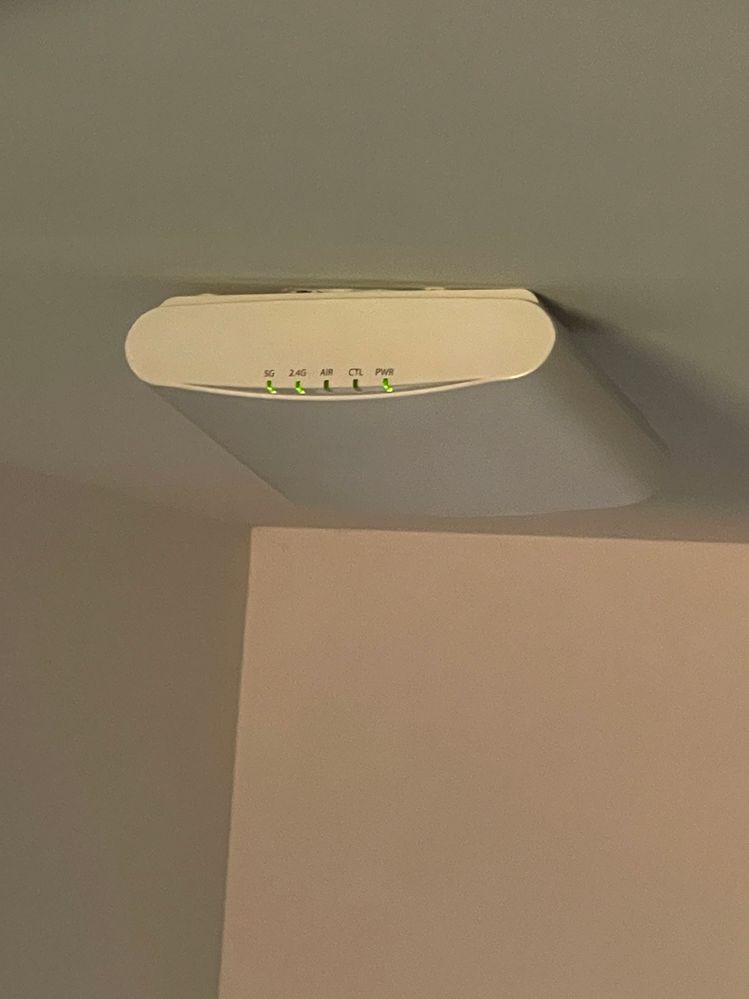

4. May I know how many Access Points are connected to the Switch? Could you please let me know the light status on the Access Points? Any of these lights are on (Please refer to the below picture and share a picture of the same)
3 AP installed in my home
AP1AP1AP2AP2AP3AP3

Hi @mp2025
As per the pictures you shared, your RUCKUS ICX-7150-C12P Switch and Access Points are in normal state.
After reviewing the case description, it appears that this problem may stem from a routing code issue on the RUCKUS ICX-7150-C12P Switch, particularly following a power outage.

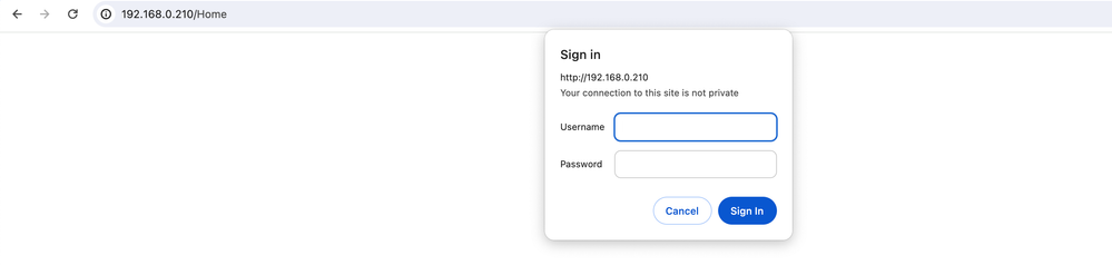

mp2025
I tried to connect switch but did not get access remotely or usb-c. Please suggest?
mp@ms-mbp ~ % ssh [email protected]
ssh: connect to host 192.168.0.210 port 22: Connection refused
ping 192.168.0.210
PING 192.168.0.210 (192.168.0.210): 56 data bytes
64 bytes from 192.168.0.210: icmp_seq=0 ttl=64 time=15.030 ms
64 bytes from 192.168.0.210: icmp_seq=1 ttl=64 time=2.834 ms
64 bytes from 192.168.0.210: icmp_seq=2 ttl=64 time=4.670 ms
64 bytes from 192.168.0.210: icmp_seq=3 ttl=64 time=4.417 ms
64 bytes from 192.168.0.210: icmp_seq=4 ttl=64 time=6.723 ms
^C
--- 192.168.0.210 ping statistics ---
5 packets transmitted, 5 packets received, 0.0% packet loss
round-trip min/avg/max/stddev = 2.834/6.735/15.030/4.328 ms
Screenshot 2024-05-30 at 12.02.44 PM.pngScreenshot 2024-05-30 at 12.03.19 PM.png
