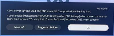

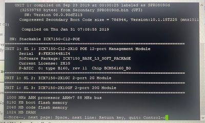

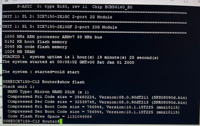

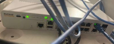

I have lived in the Lennar home since it was built. Recently started having issues with the switch providing intermittent internet. I have Eero 6 pro router provided by ISP Frontier. I have Eero 6 pros providing wifi service throughout house and they are all working fine. I only need the switch to provide Ethernet service. When I test the Ethernet lines using laptop they work but the webpages are delayed before loading and my ps5 is timing out. Attached are pictures of switch as well as error message and putty screenshots. Please advise on next steps. The r510 aps are currently not plugged in to router and not being used.

This issue is because your switch is running on the Routing code (SPR). The Switch should run on the Switching code (SPS) to avoid these issues for Lennar home users. Due to a power outage/power spike, the Switch boots up on the other partition which may be running on a ‘Routing Code’ results in causing this issue.
As I can see from the output you shared, your Switch is booted up on the secondary partition which is running on Routing code (SPR) as highlighted in the below screenshot.
Please follow the below RUCKUS Lennar Knowledge base self-help article which will help you to fix the SPR issue using Command Line Interface(CLI)

Also, I request you to please connect the Ethernet cables to one of the 12 ports on the Switch as mentioned in the below pic:
