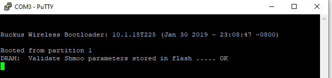

there were two rapid power outs yesterday and it knocked out my ICX7150. Upon reboot, it is no longer sending power over Ethernet. I tried rebooting multiple times. None of the Ethernet plugs are lighting up. When plugging in and booting Putty, I see that it is trying to load a partition and continually failing on a loop - it does not give me the opportunity to get in and enter any code to try to force it to boot a flash partition. It seems to be completely bricked

I was not able to find the IP address for it using that method. I instead connected directly into the unit with a USB-C cable. When I booted Putty, it did not give me the option to type. I powercycled the unit, and got this now:
It is not continuing past this line, and will not let me type. Previously, after the "stored in flash...." it would say "Failed!" and then output a lot of lines before trying again. This time it is hard stuck right here.
