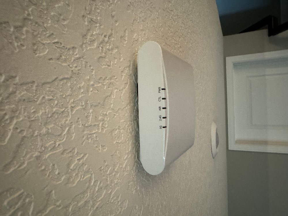

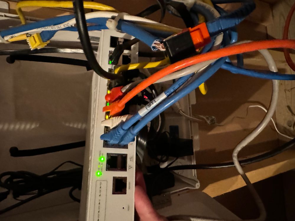

2. On your switch while it's plugged into the outlet, do you see any lights on? (Amber or green) Please let us know which lights are on. (Please refer to the below picture and share a picture of the same, showing the light status and the FULL Switch panel cable connections to the Switch ports)
3. May I know how many Access Points are connected to the Switch? Could you please let me know the light status on the Access Points? Any of these lights are on (Please refer to the below picture and share a picture of the same)
Please let me know the answers to ALL the above queries or let me know if you have any queries in this regard.
11-14-2023 02:22 PM
Hello - below are the pictures requested. Here are the answers to your questions:
