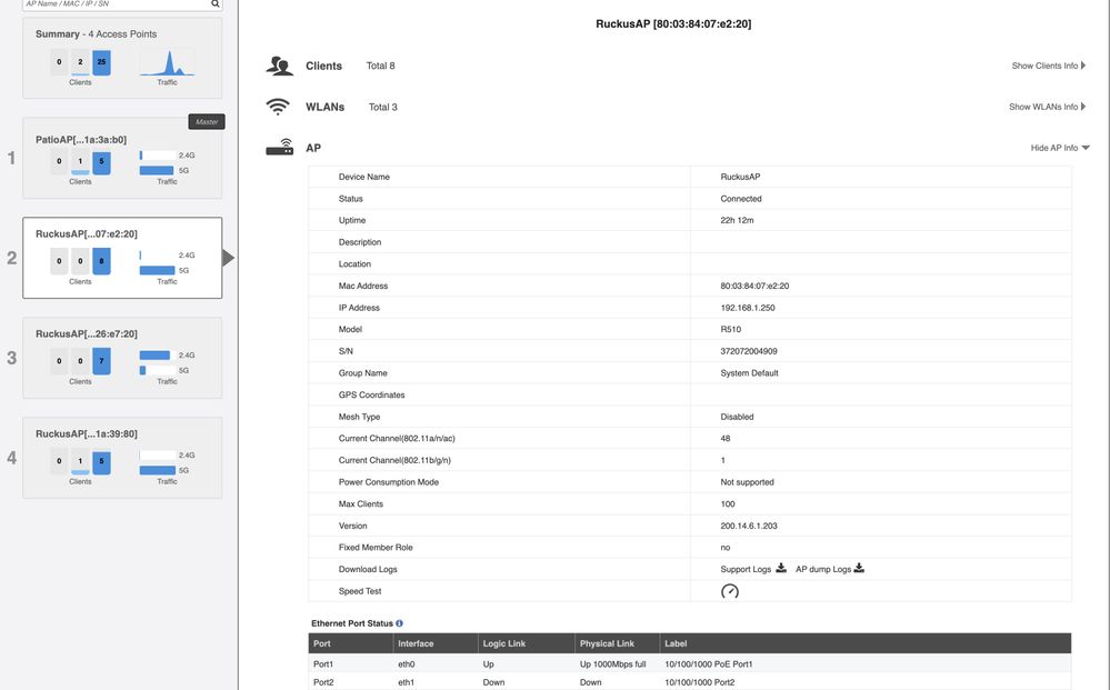

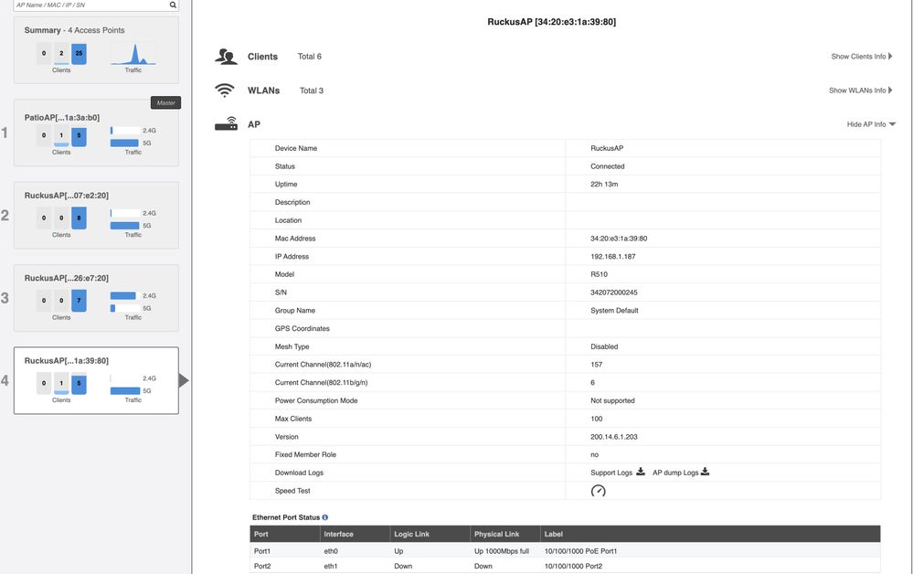

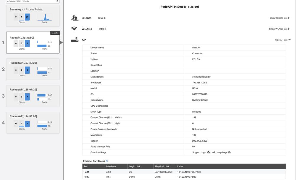

As you mentioned, you have upgraded the software. Could you please log in to your Unleashed system on a LAPTOP WEB BROWSER using the Master AP IP Address OR https://unleashed.ruckuswireless.com/ ? Please check the current version of your Unleashed Access Points and share a screenshot of the same.

Thank you for helping me with this issue. I followed your instructions and deleted the App and reinstalled it again on my iPhone. I was able to log on with my username/password. I also attached the information about the AP's software versions. I was also able to log on without a problem.

As I can see from the pictures you shared, your APs are on the latest version and are stable.
