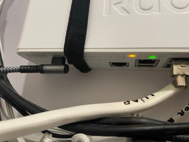

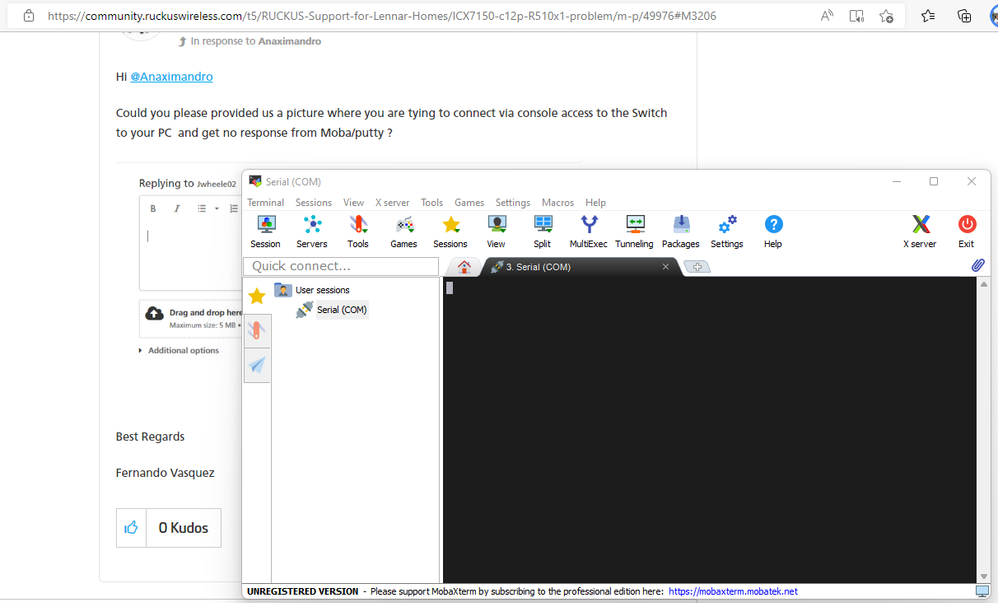

Please see 3 attachments: Picture of the connection to the ICX with USB/C, screenshoot of putty attempt and another picture with the Moba attempt. In those two attemptsconsole usb.jpgMoba 2022-12-23 235544.pngPutty 2022-12-23 235414.png, I can't get a connection from the ICX to the laptop, basically no prompt command from the switch
