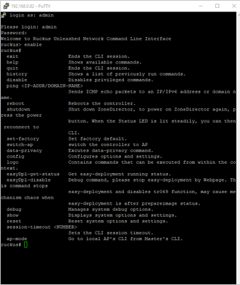

I read many other forums that all point to the routing code issue. I tried to connect with a Putty command line to my switch but the CLI doesn't accept the commands listed on other forums, such as "show flash", "copy flash flash secondary", "boot system flash secondary yes". I am attaching a screenshot of my Putty CLI window.
I see 3 IP addresses for Ruckus Wireless since I have one switch and two APs. One IP doesn't connect while the second doesn't accept the "enable" command. The third one is the one that I am showing the screenshot from above.

It seems that you are currently seeing the ‘ruckus>’ prompt in the CLI, which is associated with Unleashed rather than the ICX-7150-C12P Switch. To confirm you are accessing the Switch CLI, you should see prompts such as:
-ICX7150-C12 Router>
-ICX7150-C12 Switch>
Additionally, you should see the Switch Dashboard, as shown in the screenshot below, to verify the Switch IP Address.

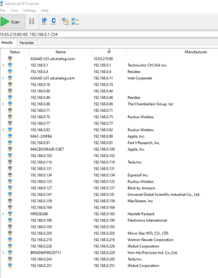

I see 3 IP addresses associated with Ruckus as shown below. I tried each one of them and I am not seeing the command line or the switch screen shot you shared with me. How do I see the IP address for the switch?

Hi @asaad1972
Thank you for your response and update.
Since the IP address 192.168.0.75 appears to be inactive, it may be related to the Switch. Please try rebooting your ISP (Internet Service Provider) modem-router combo device by unplugging it from the power outlet, waiting a few moments, and then plugging it back in. After performing this reboot, scan for IP addresses again to check if the Switch IP address becomes active or any new active IP address assigned to the Switch.
Please confirm if this resolves the issue.
asaad1972
Hi Imran,
I followed these steps but I am still getting 192.168.0.75 inactive state while the two other IPs are active. Here is a screenshot of the switch box in case you find any clue. The Ruckus network is working at the moment but very slow.
