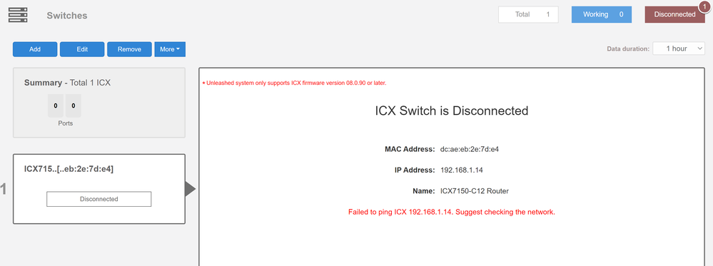

I am unable to connect to the switch in a lennar home. APs are working, switch is not showing as connected in the unleashed portal.
Tried connecting through putty and mobaxterm but unable to connect..
Did an IP scanner and identified the IP with correct MAC address. But somehow unable to connect. I tried to connect directly to the laptop via the USB-C port, but unable to open either telnet/ssh/serial connection.

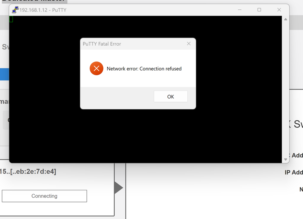

I tried telnet through the console port but I am unable to connect. Command line is not opening up but refuse to connect. I tried to console via usb but the same result. I tried the same with over wifi as well. I am able to ping the router successfully.

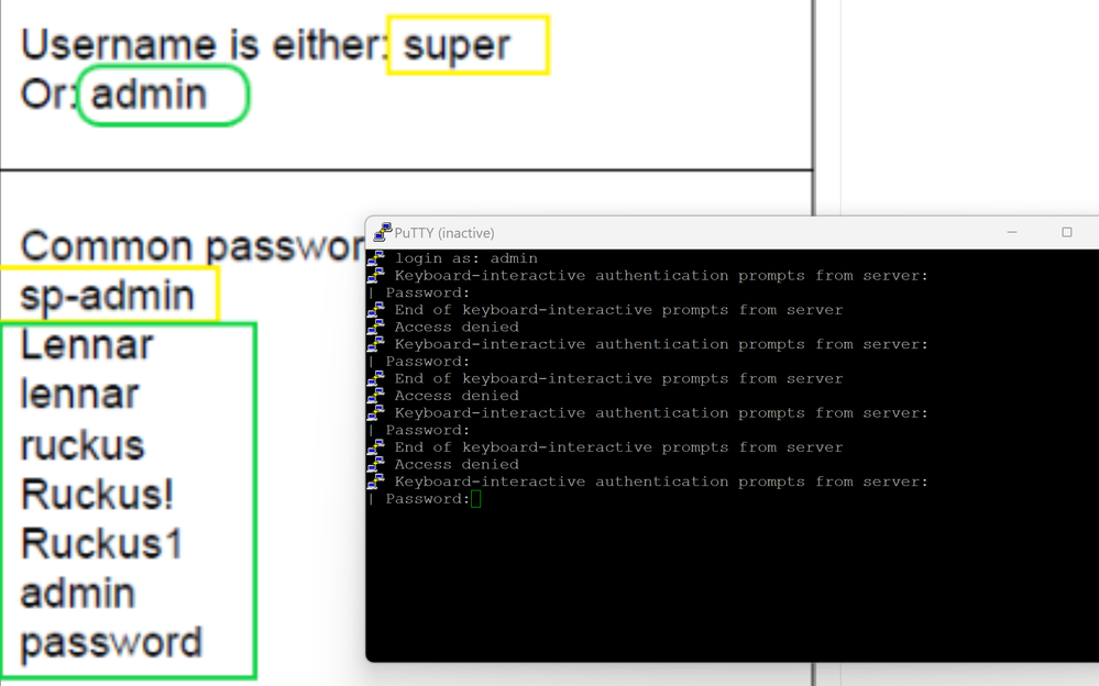

Could you please try to log into the Switch CLI using SSH once again, using the default credential?
Switch default credentials will be as mentioned below.
Username: super
Password: sp-admin
If the above credentials don’t work, you can try below default credential combinations as well.
If any of the above credentials don’t work, please try to factory reset the RUCKUS ICX-7150-C12P Switch as described in the below VIDEO and once you perform the reset try to log into CLI using SSH with the above-mentioned default credentials again.

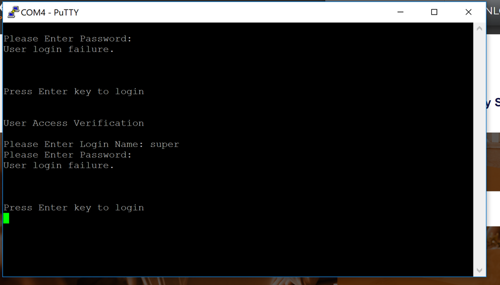

I did a factory reset of the switch as described in the video, the switch status lights flashed and rebooted. However I still can't access the switch by any means. I tried connecting ssh with default credentials - access denied. Tried telnet - connection refused. Tried console - Nothing happens. tried via browser - access denied. Completely blocked on bringing switch back. Please advice the next steps. I am not sure why console connection is not working, I did install the USB driver for console connection but nothing seems to be working.

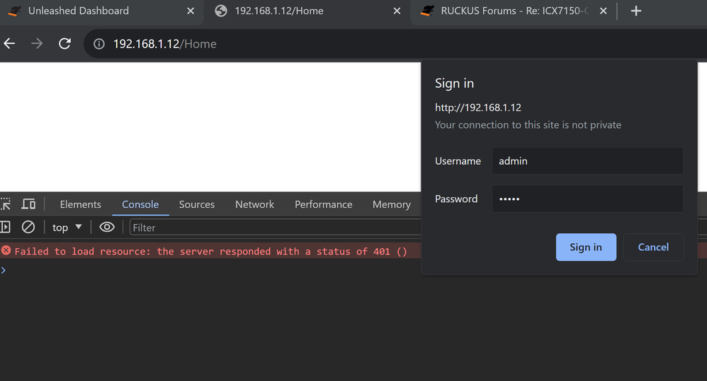

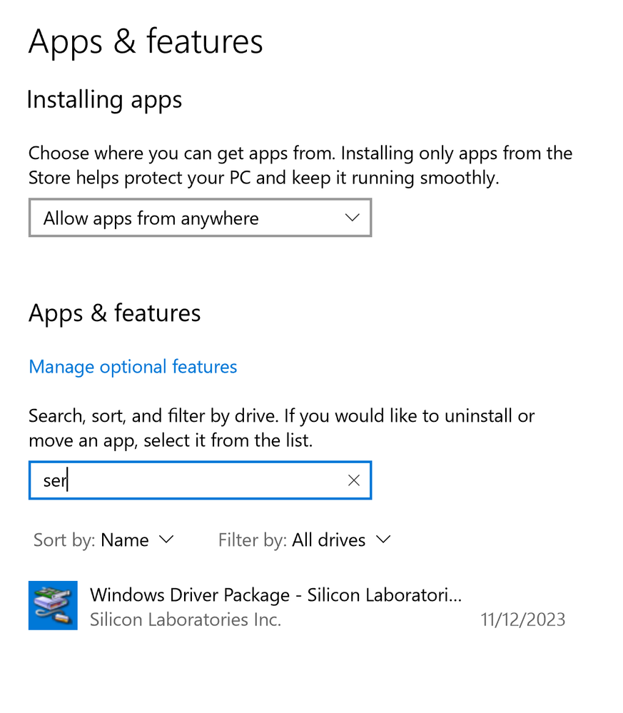

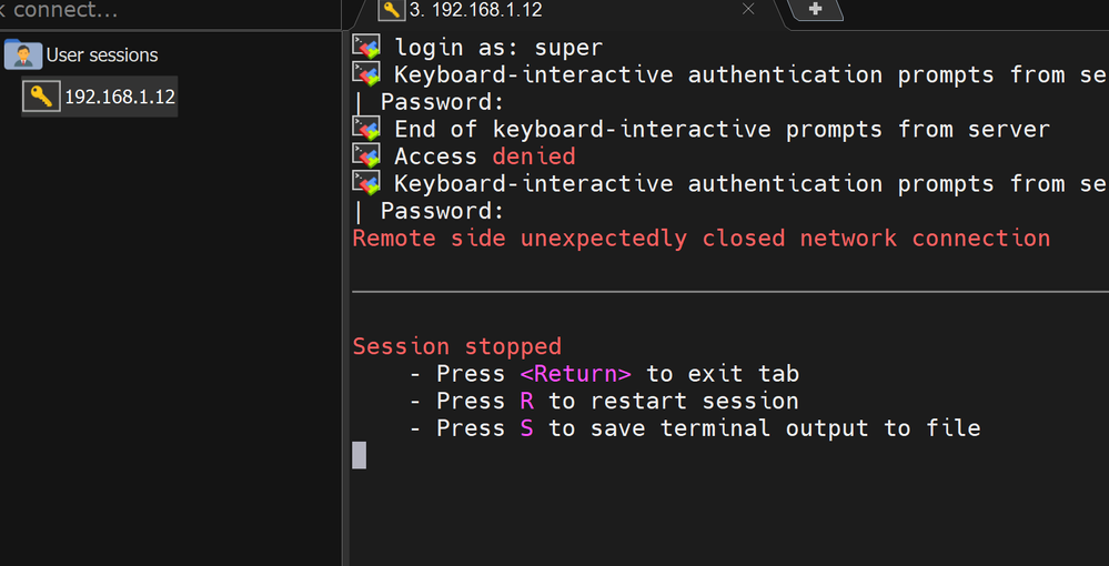

11-12-2023 12:39 AM
Hello Imran,

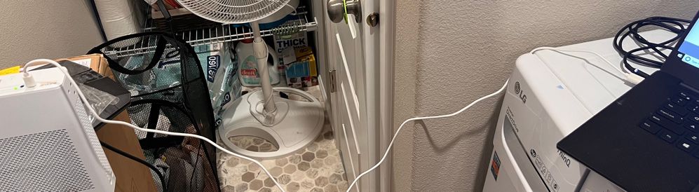

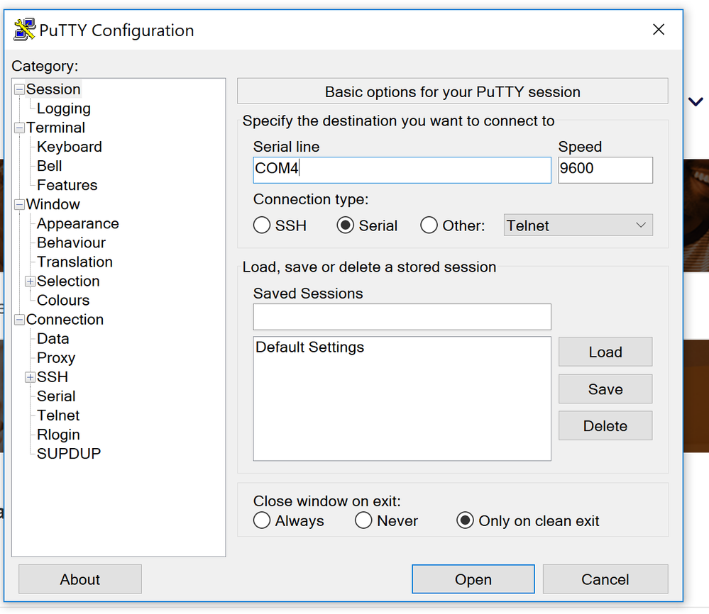

Sorry for the delayed response. However I tried to connect to the console exactly like the document you sent, No luck. It is not letting me connect via mobaxterm/putty. Asking for login and never takes me to the switch or router console. Please see the attached images. Please advice the next steps.
