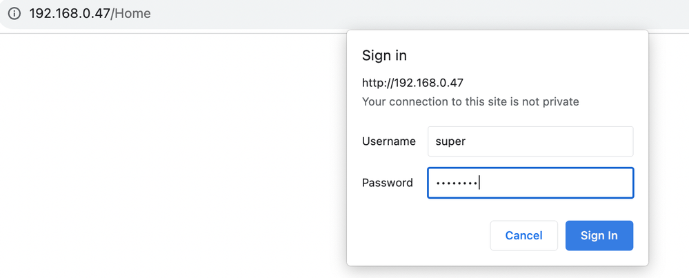

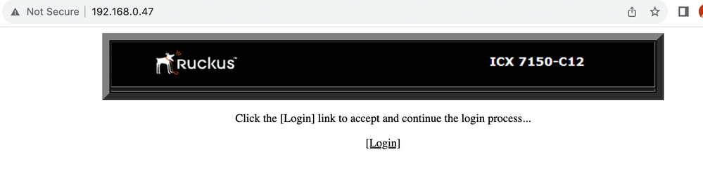

12-07-2023 01:47 PM - edited 12-07-2023 02:42 PM
Thank you...yes you were right, I was logging into the AP and not the switch. Got the correct IP now but can't login. I've tried the super:sp-admin but it won't work. I even factory reset the switch and still can't login. Also, cannot connect via SSH - says connection refused.
