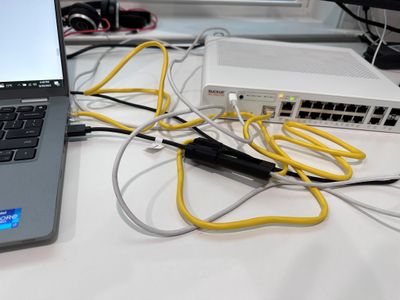

Also, please share a picture showing the software recovery cable connections between your Switch and the Laptop/PC.

Hello, I have attached the screenshot that is connected b/w my computer and switch.

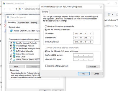

Ethernet configurations on my computer:

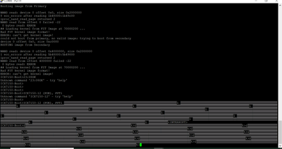

There is no keyboard issue. as I said in earlier, when I plug ethernet cable then console will not accpet any inputs and it behaves it's own way as shown in below screenshot. It is not only print 'P'.
when I remove ethernet cable the console start accept the user inputs as shown below. Please do provide some valuable troubleshooting steps instead of reboot and re-plug power cable as I have done enough troubleshooting last one week then I end up open a case on community.

Hi @akkemgari
As I see from the screenshot, the ethernet cable you have used for the software recovery process is plugged into the incorrect port on the Switch panel. It should be plugged into the correct port as marked in the screenshot below. Please use ethernet cable (both ends RJ45 plugs) and USB to type C cable together as described in steps 2 & 3 in the guide link. Request you follow the same and perform the software recovery process once again.
