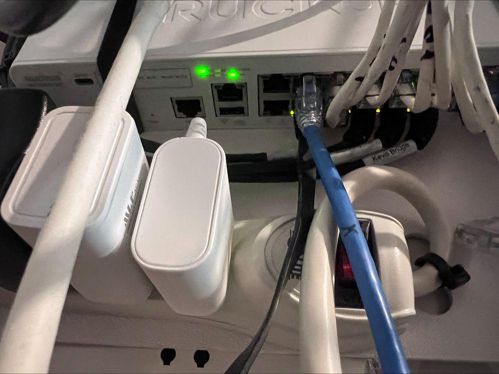

1. On your switch while it's plugged into the outlet, do you see any lights on? (Amber or green) Please let us know which lights are on. (Please refer to the below picture and share a picture of the same, showing the light status and the FULL Switch panel cable connections to the Switch ports)
2. May I know how many Access Points are connected to the Switch?
processed-2E4346A0-2D9A-478B-9D26-870ADEC2E8C5-98A1EC41-CBDE-4E51-9244-D31EF3B5BDAA.jpeg
1. Port that has an access point connected have lights off
2. There are three, and all are down with no lights.  When I tried resetting, I disconnected all of them and just had one.
3. All the lights in the access point are down.

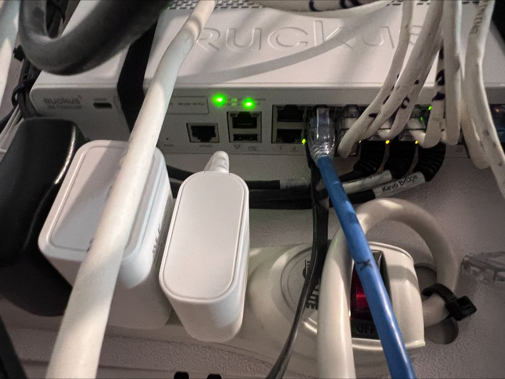

processed-F56B711B-C8AF-4831-83A0-46E9A9A7BAAD-1DE0CCE6-B865-4C33-9E4C-2761188B3C53.jpeg
Hi @Karthick
As per the light status of your RUCKUS ICX-7150-C12P Switch, it seems normal.
We may have to check the ports and some other information of the Switch from the CLI access.
Please follow the below steps to access CLI and get the output of the below-mentioned commands.
ICX7150-C12 Router> OR
ICX7150-C12 Switch>
show version
show flash
show inline power
show interface brief
