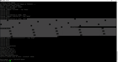

08-30-2023 04:07 PM
Hello, I have attached the screenshot that is connected b/w my computer and switch.
Ethernet configurations on my computer:
There is no keyboard issue. as I said in earlier, when I plug ethernet cable then console will not accpet any inputs and it behaves it's own way as shown in below screenshot. It is not only print 'P'.
when I remove ethernet cable the console start accept the user inputs as shown below. Please do provide some valuable troubleshooting steps instead of reboot and re-plug power cable as I have done enough troubleshooting last one week then I end up open a case on community.
Thank you.
