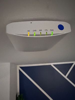

I have connected and one of AP is not functioning and speed is very low as compared with internet provider device.

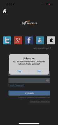

and, I am unable to login in Unleashed app. getting network connection error but I connected to the Lennar wifi. I was able to login via webbrowser but didn't work to connect app.
I have allowed network connect on app.
the error I am getting on app.
09-01-2023 08:11 AM
Hi @akkemgari
It may be because of the old Unleashed version.
Could you please login to your Unleashed system on a web browser using the Master AP IP Address or ‘unleashed.ruckuswireless.com’? Please check the current version of your Unleashed Access Points and share a screenshot of the same.
Please refer to the below screenshots for more information on how to know your Unleashed Access Points version details.
Please check, help us with the above-requested information, and let me know if you have any queries in this regard.
