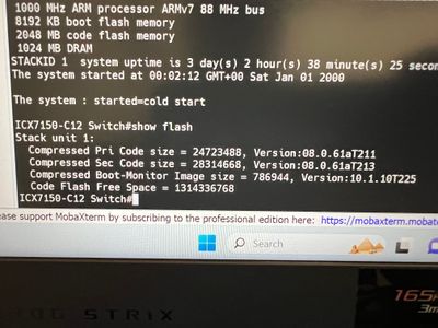

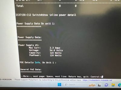

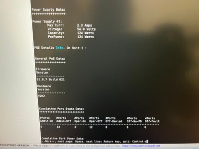

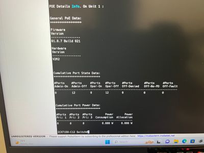

We may need to check the Switch ports information from the CLI access. To check the same, please follow the below steps and help us with the output of the CLI commands mentioned in this post below.
ICX7150-C12 Router> OR
ICX7150-C12 Switch>
show version
show flash
show inline power
show inline power detail
Please share the output of the above commands or share the screenshots if stuck at any step or error (if any) and let me know if you have any queries in this regard.
Here are my response to your request. I am not sure if it matter but wasn’t able to acces the switch using wireless or Ethernet only usb
