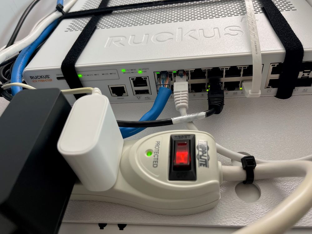

My ICX 7150-C12P switch is currently up but is randomly rebooting itself. I have a single R510 AP connected to the switch. This started happening several days ago; the switch reboots about every 10-20 minutes, stays up for a while, then starts rebooting itself again randomly. The AP has been updated to the latest 200.14 firmware.
I verified my internet connection is functioning normally (had Spectrum tech out to check yesterday).
How do I go about resolving this issue?

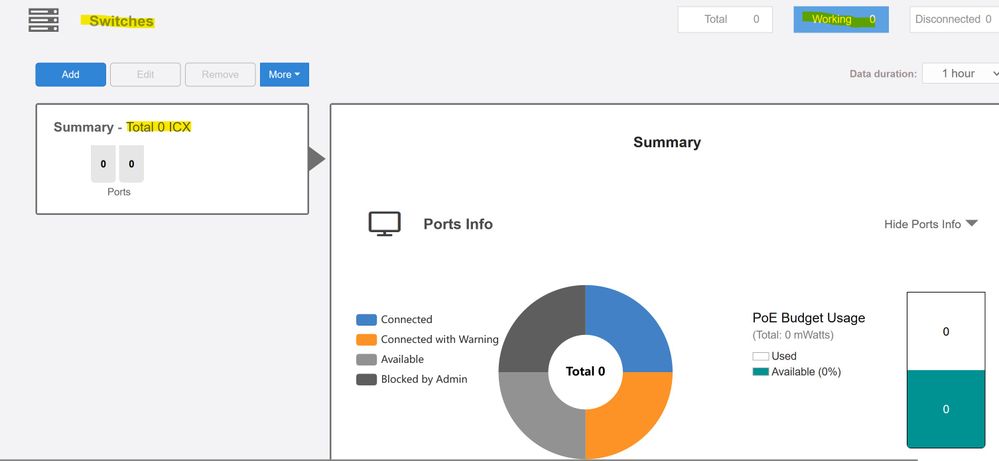

May I know how many Access Points are connected to your ICX-7150-C12P Switch? If you have more than one Access Point, please check if all the Access Points are upgraded to the same version. All must be Upgraded to the same version. Please refer to the below screenshot as an example.
Also please share the screenshot showing the below information.
Please check and confirm and let me know if you have any queries in this regard.

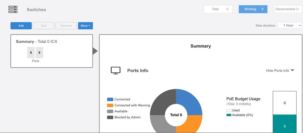

Current AP firmware version is 200.14.6.1.199. Switch is not showing as connected, but AP is connected to port 1 on the switch. Pics attached.

07-20-2023 12:40 PM
As I said the switch does not show as connected on the dashboard: "Total 0 ICX". I don't know how to obtain the information you're looking for?
