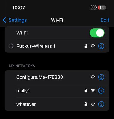

the configure. Me seems to work ok but the network after attempting a few times and create different doesn’t seem to behave at all.
Not sure I have completed the following task yet the network never really connect. It will try to connect for a while then just just times out basically.
the 2nd ap didn’t connect automatically or at all. One android device says that it failed to obtain an Ip. Also the DNS says unreachable.

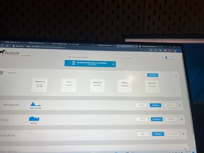

Hi @akalala
As you mentioned your access points are not getting connected to single Unleashed system after factory reset, are you seeing Two different IP addresses for both the APs?
If yes, please log in to both the Unleashed systems and check the Unleashed Versions, both need to be on the same version in order to have a single Unleashed system with a Master AP and slave APs. (Please refer to the below screenshot to check the Unleashed Version).
