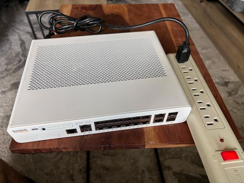

Hello, my ICX 7150-C12P will no longer power on, no lights no response. I have tried multiple power outlets and power cables. I would like to replace it, please let me know how to proceed. 24-11-19 13-55-24 8138.jpg

Based on the details you've shared, it appears that your RUCKUS ICX-7150-C12P Switch is not operational.
If that doesn't work even with a working power cord or other power outlets, I recommend again attempting a physical factory reset multiple times, as outlined in our RUCKUS Lennar Knowledge Base self-help article accessible through this link and VIDEO:
https://community.ruckuswireless.com/t5/RUCKUS-Lennar-Support-Knowledge/Process-for-performing-a-phy...
Video link: https://www.youtube.com/watch?v=6jHMTdo_hK4
If the initial reset attempts do not resolve the issue, please try resetting your switch multiple times (approximately 10-15 times) using the method described in the article. In some cases, repeated attempts have successfully resolved similar issues. Upon successful reset, the SYST and PWR lights should turn GREEN.
Please proceed with these steps and let me know if the switch powers on successfully afterward.
Thank you for your patience and cooperation in this matter.
Jxck
I have attempted the reset using method in the links you provided several times. Same outcome, when plugging it in the lights briefly flash but none of them even stay on, they all go dark, and I hear a small noise from I think the power supply.
Thanks for the help, let me know how to proceed since I still have the issue.
