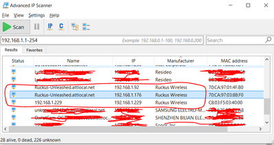

Hi, I have three options for Ruckus VPN, does it matter which one I select?
11-11-2024 10:55 AM
image below
11-11-2024 11:04 AM
Hello @Amulyabhat ,
Thank you for the response shared.
From the response you shared, I would request you to please go for the third option which is for the Ruckus Switch, which is 192.168.1.229.
Please use the IP address to login to the Switch CLI and follow the instructions as per the article.
