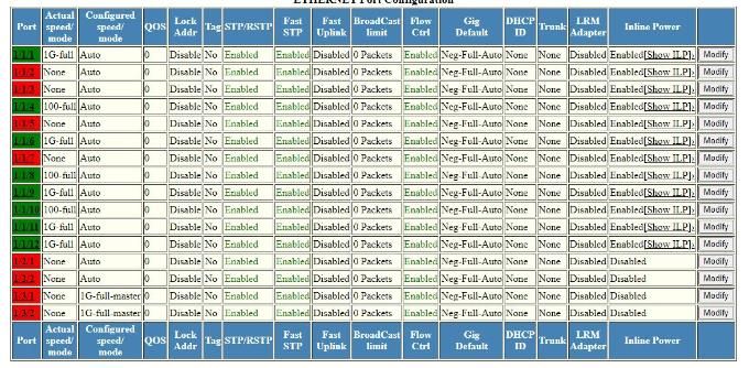

Ended up being an ethernet port on the switch (1/1/8) had gone bad and failed to pass gigabit ethernet. It refused to go any higher than 100Mbps. Ruckus is replacing the switch.

After a lot of digging and guessing I was able to connect to my switch via a browser (came to find out latter that the installers disabled Telnet). I made my way to the Port->Ethernet submenu where I found this table:

I'm right back where I started. I had to change the speed back to Auto (10Mbps) because my NAS becomes unreachable if I have the higher speed set on my port. Can anyone offer some suggestions?
