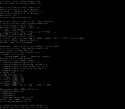

12-22-2023 11:31 AM
It still gives me the same response. Picture below:

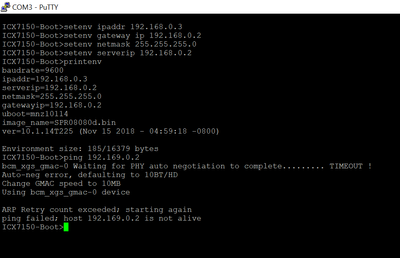

I have the same error everytime like @AM15.
ARP Retry count exceeded; starting again
ping failed; host 192.168.0.2 is not alive
ICX7150-Boot>

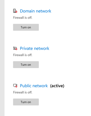

My firewall is off already. Closed Putty and did all the steps all over again and keep getting the "not alive" error
