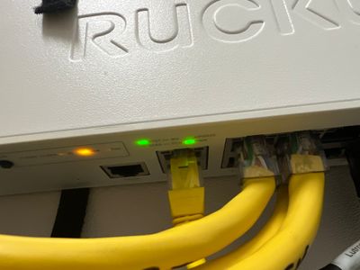

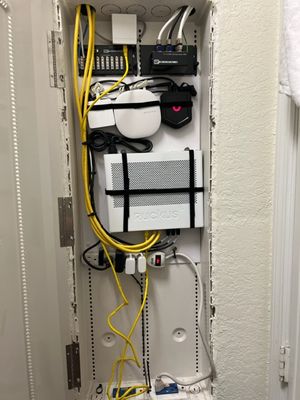

Please let us know the LED status of the switch and the access points using the below guide.
R510 LED lights
RUCKUS LED lights
Also please share the image of the switch and the access points showing the LED status and the cable connections.

Hi @Btissam
Thanks for your reply.
Based on the images you have shared it seems like the cable coming from the router has been wrongly connected.
Please make sure the cable is actually connected to the ICX-7150-C12P ( Switch ) In one of the 12 ports in the middle as mentioned below.
09-14-2023 09:23 AM
I did changed it, but this is not coming from the router, because I don’t have a router, I have a T-Mobile gateway that is located in a different room . The wire you asked me to change comes from her:
