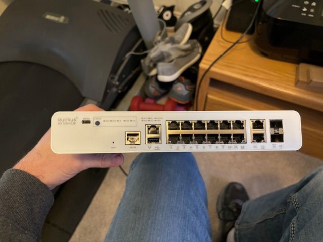

2. On your switch while it's plugged into the outlet, do you see any lights on? (Amber or green) Please let us know which lights are on. (Please refer to the below picture and share a picture of the same, showing the light status and the FULL Switch panel cable connections to the Switch ports)

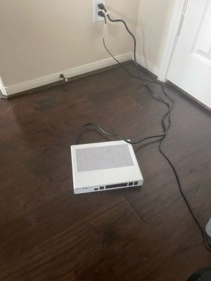

Please plug your ICX-7150-C12P switch into a power outlet and send us a picture and video of the switch showing the light status and the power cord as mentioned below.

here is a picture of the device plugged in. I will upload the video of it being plugged in once access has been granted to that Google Drive folder.
