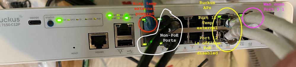

2. On your switch while it's plugged into the outlet, do you see any lights on? (Amber or green) Please let us know which lights are on. (Please refer to the below picture and share a picture of the same, showing the light status and the FULL Switch panel cable connections to the Switch ports)

PMcCaw
Hi Imran,
I tried to get the best picture I could and also mark the details on the second image.
Please let me know if this is what you are looking for, or if I need to retake them.
Thank you, for your help and assistance!
